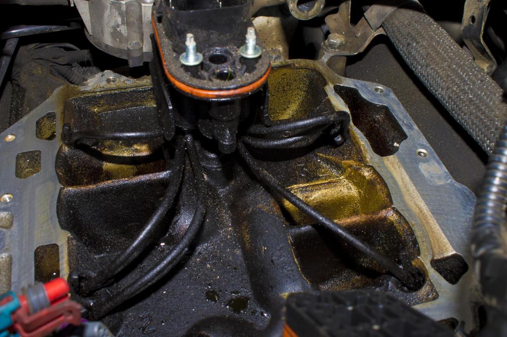

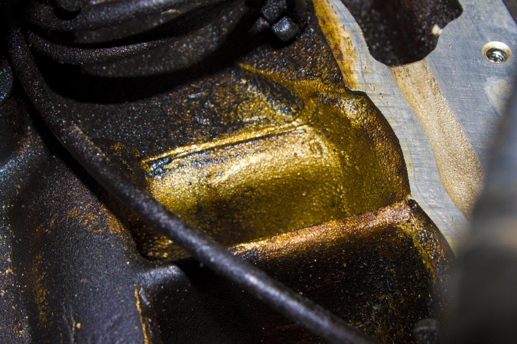

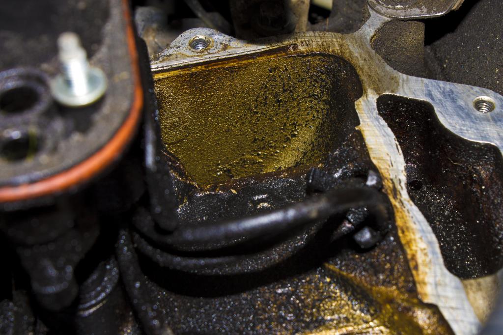

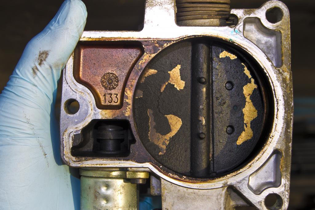

So while I had some down time, I decided to take off the upper intake to see how things looked, as I hadn't done this yet. The extent of checking the intake was with an LED and dentist's mirror. I noticed some washing on the #4 and #6 intake runners, a small amount on the #5 runner, as well as a small spot on the underside of the TB. I checked with the BAR gauge again, and the numbers are spot on with my previous readings. Still not showing a leaky injector or regulator. So my next question is, are the poppets on the #4 and 6 injectors getting stuck? Someone has been in the top end of the motor before, as the safety clip on the main injector connector was not in place and pinned underneath a vacuum line that was run in between some wires in the main harness.

Looks like you may have a leak in the rear corners of the plenum gasket. Doesn't appear it was sealing completely causing a vacuum leak. Odd # cyls are on the driver side A leakdown test would verify a leaky poppet. If leakdown is within specs, no leaky poppets Might want to consider the upgraded injector assy. Amazon & Ebay have some good prices. Delphi #FJ10565.

wow thats pretty nasty, although mine wasent very clean either after only 73000 miles.

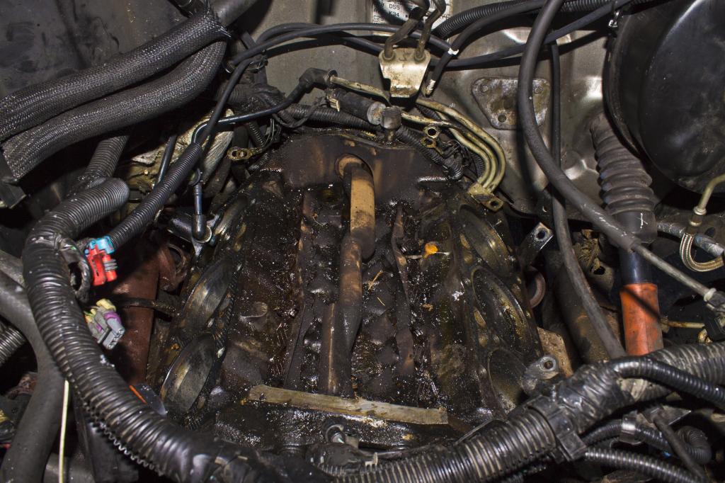

Well, I figured since I'm in this far, I called into work for the day and am going to do a total top end rebuild from the pistons up. Taking the intake off is something I only want to do one time throughout the life of the truck, so I'm going ***** deep on this one. New valves, new gasket set, new head bolts, new intake (I have one laying around with less than 5K on it) and a new set of injectors, if my wallet can accommodate it

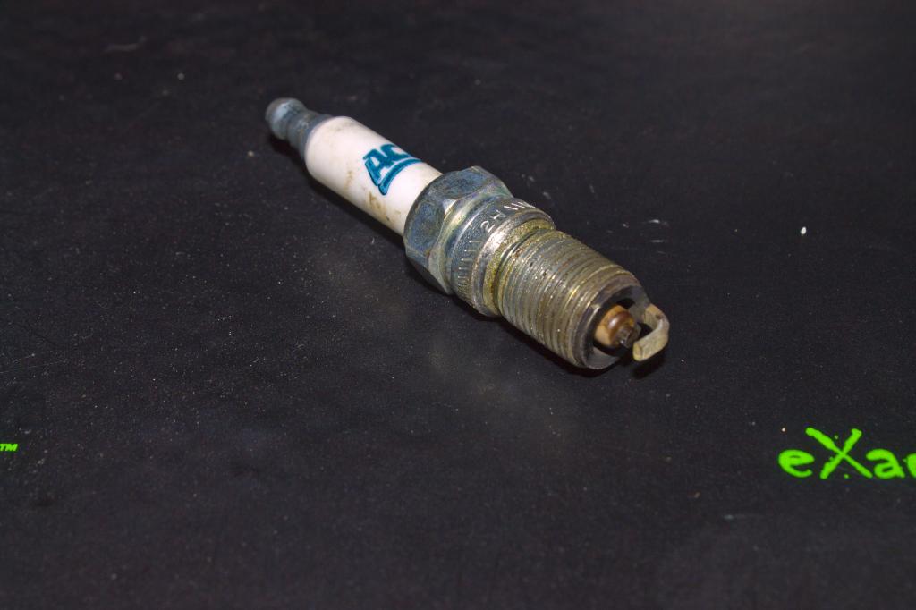

So got the motor down to the block. Things seem a little more dirty than I am used to, but I can't expect every Blazer owner to go as in depth as some of us One thing I really noticed, more than anything, was how fouled the plugs are, seeing as there is less than 250 miles on them! Well this is one of the reasons I am going so crazy with this truck right now. It's pure frustration at this point, and I am the type of person to just say "F*&% it, I'm replacing EVERYTHING." So that's where we are at now. I can't take another day off for this truck, but I will work little by little for the next 2-3 days and update along the way. Yippy!
