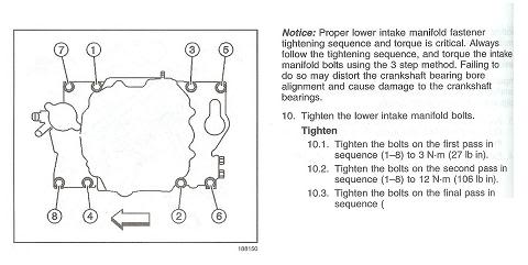

Mighty good lookin' Blazer. It would be a shame just to let it die. Amazon & Rock auto are your friends when it comes to parts. Felpro MS98002T intake gaskets for sure! The injector upgrade manufacturer is not all that critcal, they all work. The Delphi comes with the new bracket so keep that in mind when price checking. If you chase the threads on the lower intake bolts, you won't need to replace them, but you do need to put sealer/locker on the threads. Follow the sequence & torque spec, very important.
Good luck & keep us posted, (I know you will).

Thanks for the diagram Captain. I never did multiple passes on the tightening sequence. Always just went straight to ~160 in/lbs and in a completely different sequence (pretty much dead opposite, starting from drivers side)

The diagram is right out of the GM shop manual. As long as you go in a circular pattern it's fine, doesn't matter which side you start on, but multiple passes are important to make sure it pulls down evenly.... ya don't want to tweek the block
