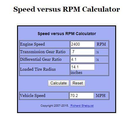

BTW: here's the result of the calculator with 4.10 gears and an effective radius of 14.1" tire diameter:
Scott, assuming the tachometer and speedometer are correct, having had the gears in the front and rear axles swapped to 4.10:1 would explain the high engine speed at 70 mph. (Both sets of gears should have been replaced for the 4wd to work properly.) This would make your Blazer have a more aggressive gearing, just not in the transmission.
BTW, for the above calculations assume the speedometer reading is your actual speed. This is why I asked if you had checked your speedometer against the speed reported by a GPS.
But as swartlkk pointed out, it would be important to check that the torque converter is locking up properly. If it is not locked up, it will be slipping and the engine will have to run faster for the same ultimate speed.

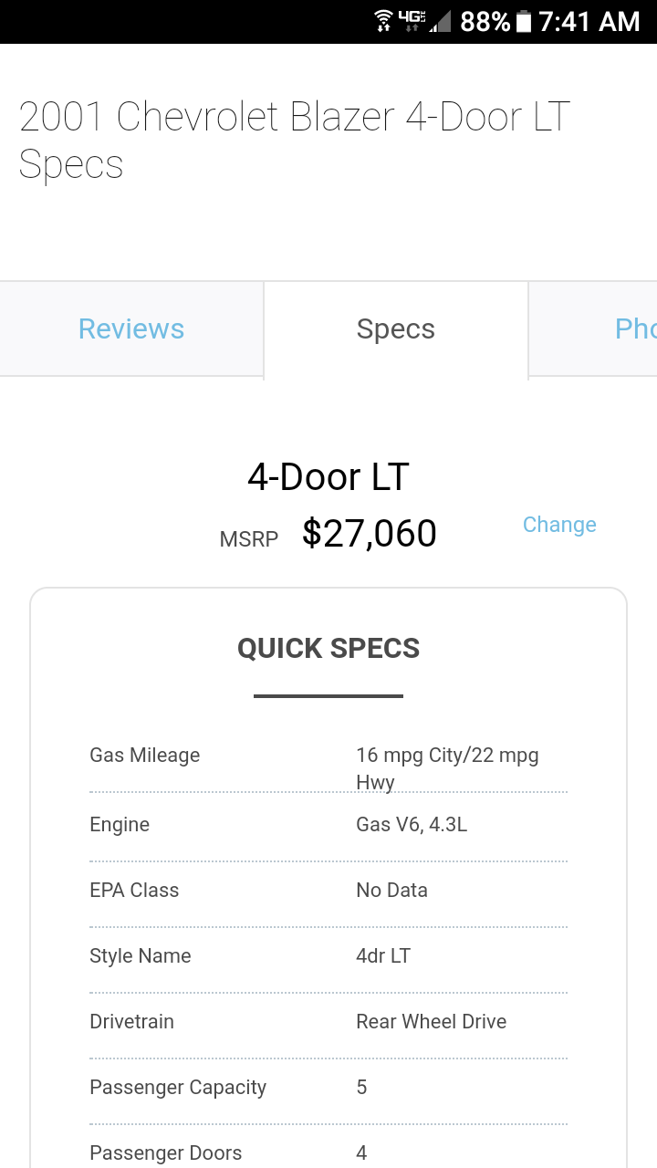

(Overdrive) there is a substantial and noticeable drop in RPMs. That can only be in the transmission not the differential. Regarding the mileage please see picture. It is the specs of a 2001 four-door two wheel drive.

My understanding is that the 2wd Blazers tended to have lower rear-end ratios and along with less mass to move and less friction in the drive train would be expected to get much better mileage than a 4wd version which more than likely had higher ratio gears in the axles.
