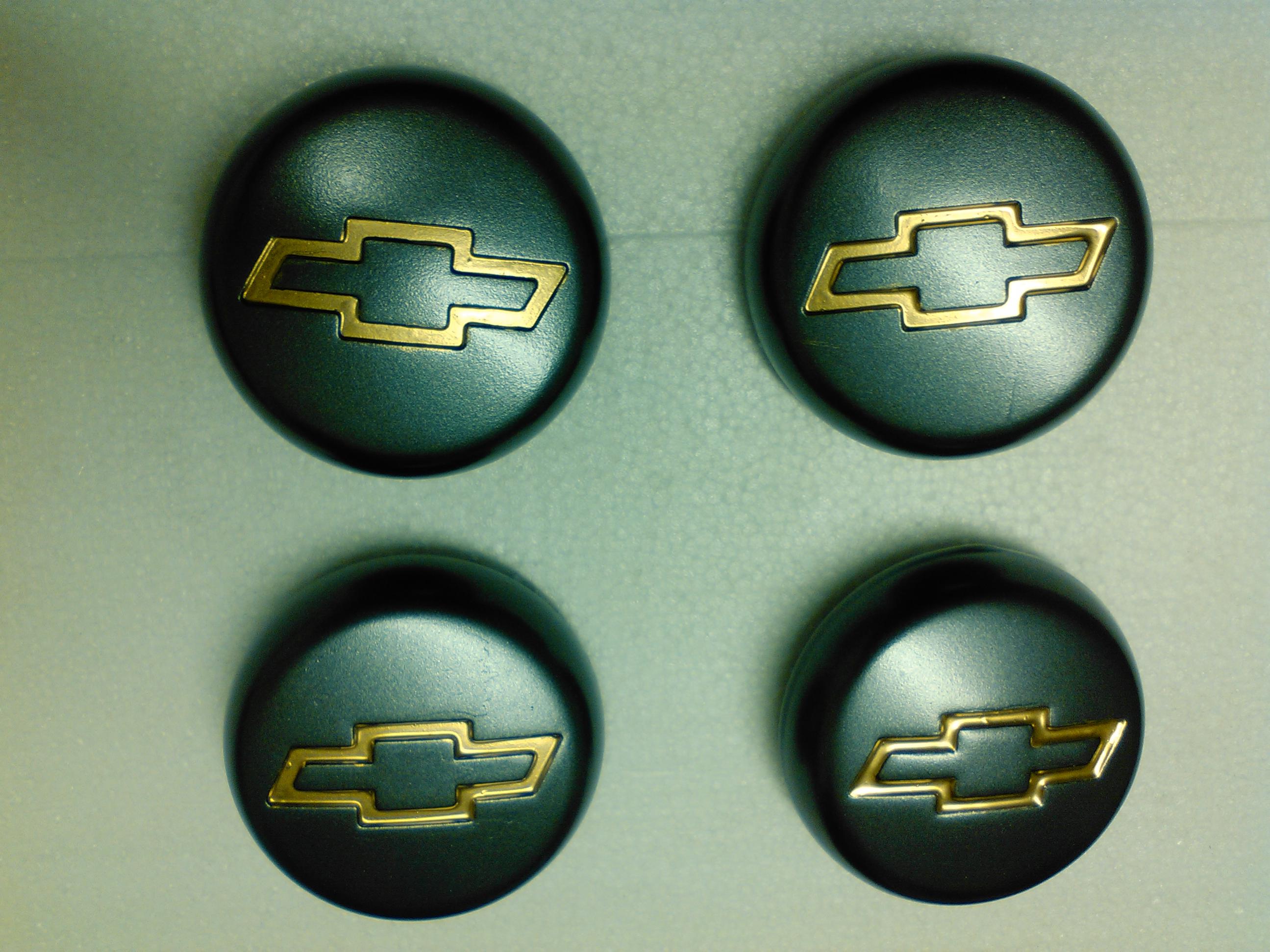

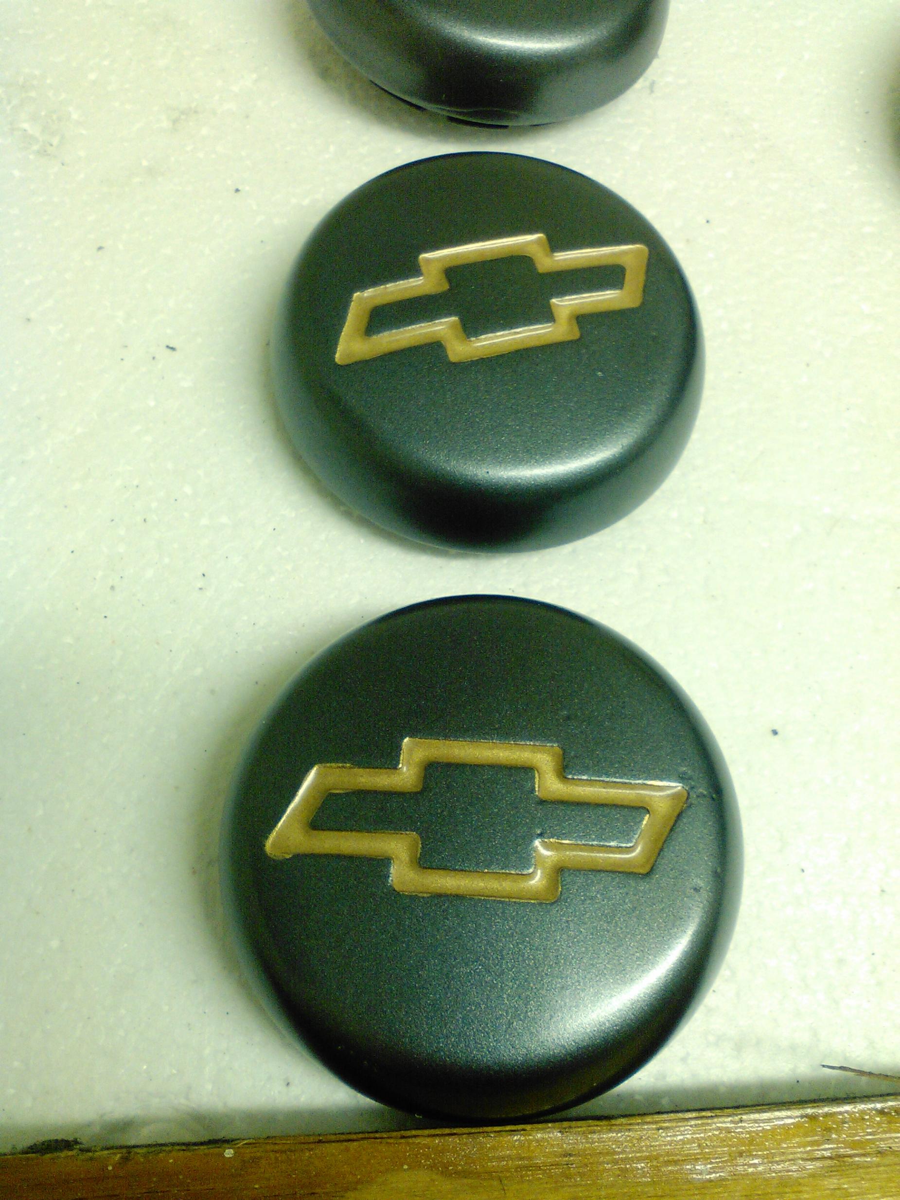

As per the Pope when he was riding with me; back in the 80's, He was more concerned about where I was going to spend my after-life instead of my center caps. I just read the instructions on the can and all worked well..3 coats was good enuf for me...pics of phase 2(the bowtie) and the Pope....Tony.

ok, after the clear coat this is what you get, see pic.
I would and/or will do this process: sand, colour, clear coat then the bowtie last...the clear coat dulled the gold paint.
1st: sand
2nd: 3 coats of paint
3rd: 3 coats of clear coat
4th: 3 coats gold paint for bowtie....
