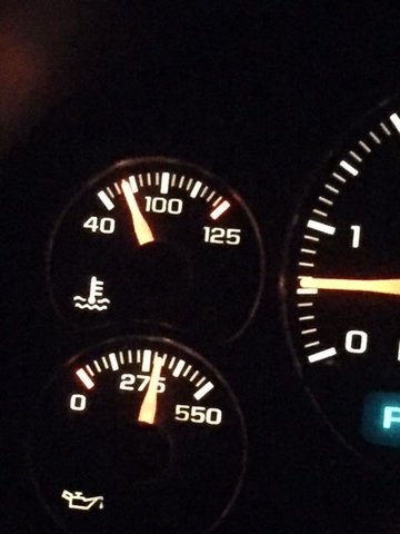

Dear all,
I fitted the correct radiator today. Jacked her up as explained by 2001ZR2. Filled her up with coolant and took her for a run . The temp doesn’t go above as shown.
Is this the correct temp? Is this the correct temp

I am assuming the gauge is in Celsius so you should be at about 88-95 degree C. Are there aftermarket electric fans? and is the Thermostat installed?
In the US it would throw a code for not reaching operating temperature for emissions reasons.
no electric fans mate. No error messages.
yes I need to check out the thermostat!
