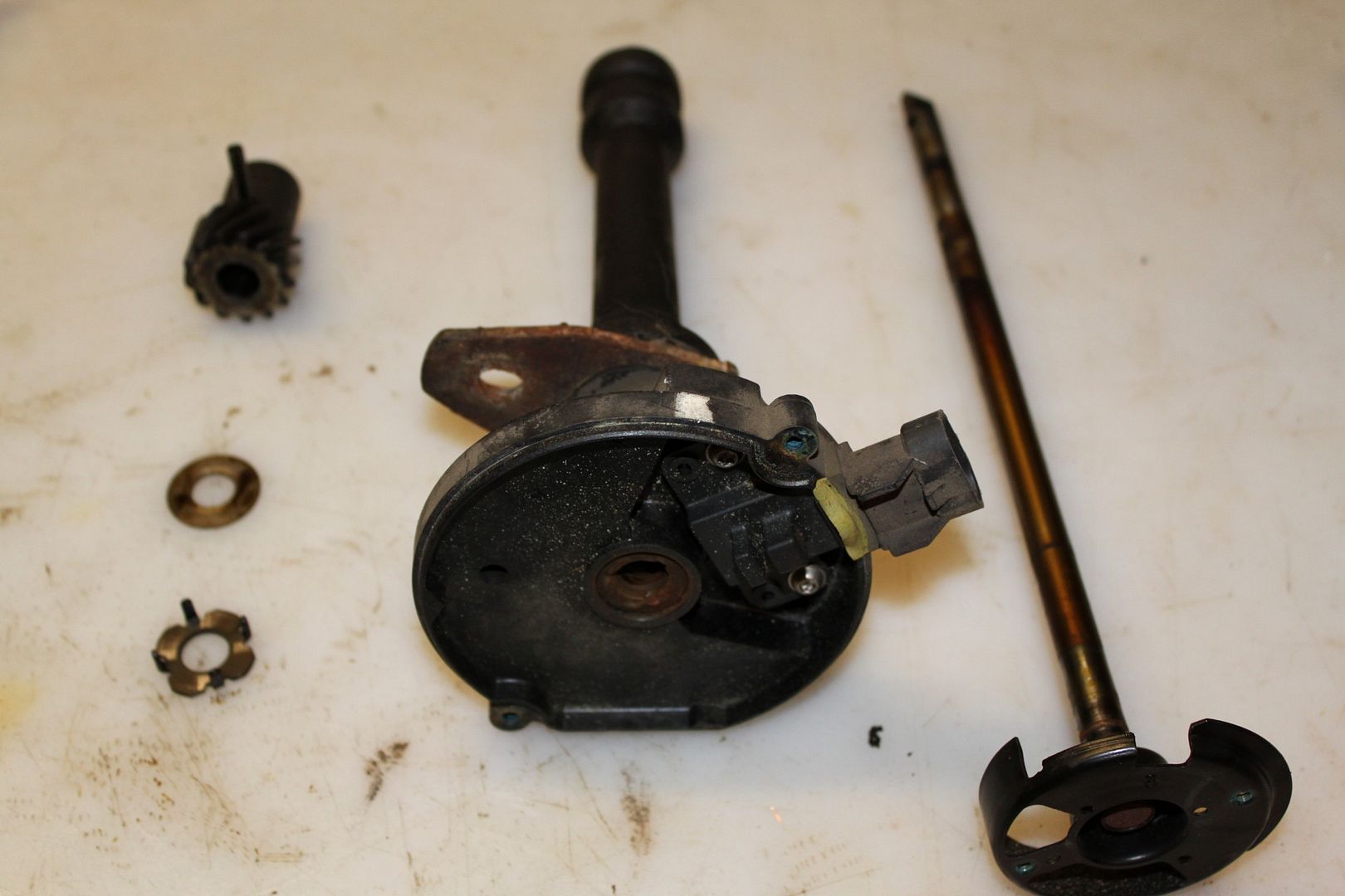

Posts: 41,341
Unbolt it and pull it out of the block. Done. You'll need a 10mm wrench to get the bolt at the base of the distributor out.
This picture shows the distributor retaining clip that is a few inches below the top of the distributor:
