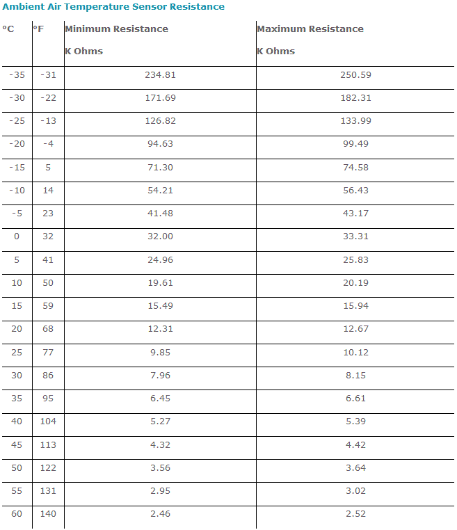

The temp display on my overhead console usually shows "--" but every now and then will show some crazy temp for a few seconds or sometimes "OC" when I first start it. Is this the ambiant air temp sensor located behind the grill in front of the radiator?
Old Nov 16, 2009 | 04:21 PM
Posts: 41,341
Sounds like your sensor is bad. You can check the sensor by testing the resistance per the chart below:

Well, just got back from the junk yard and for the price of admission ($1) I got three sensors. I didn't have the blazer with me and was going off what I remeber the sensor looking like.
Two of the sensors I got had a single probe sticking out the end of the plug and the third one looked like it had two probes in the plug itself. I knew I had a single probe but I figured what the heck.
The two single probes worked and are only 1 degree off from each other but they are a bit bigger than my stock sensor. The double probe gave me an "OC".
So, for fiddy cents each I got a working OHC temp guage and a spare sensor. I remember a few years back I asked about at the dealership and they said it would cost $40 to do a scan to find out what the problem was and then however much to fix the problem.
