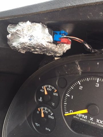

Can anyone shed some light on these please?
I swaped out the 4WD switch at the weekend, (4WD now works ��), on removing the dashboard to do this I came across this wrapped in tin foil. Anyone know what it is and why the tin foil please?

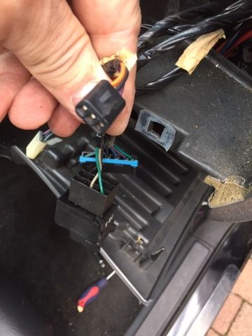

Also I found a disconnected wire behind the dome light switch, any ideas what it is for?
Whilst I had the dome light switch off I found the bulb that illuminates it has failed as have some of the bulbs in the 4WD switch. Does anyone know what type they are please?

no idea but i dont think its stock
Old Oct 22, 2018 | 06:14 PM
Judging by the gauge units of measurements and the background of the photos, this is a right hand drive Blazer?
Not really sure about the foil... Peel it off and see if there's a part number on whatever it is? Do you have working remote entry key fobs? Maybe a previous owner got paranoid and covered the receiver module for it with foil? Lol I don't know, just throwing out ideas.
The plug, possibly the plug for fog lights if your Blazer is not equipped with them? US Blazer's come pre-wired in the dash at the switch for fog lights, although the plug looks different...
Ha ha...I was thinking the exact same thing.
Old Oct 22, 2018 | 08:20 PM
A camo box to prevent being seen by the all seeing eye....
but it does look about the size of the alarm system box.
totally thrown off by the tin foil... wonder if theres something hidden inside... none electric..........

Thanks for the advice guys.
yep it’s a RHD truck in the UK.
rear fog lights are connected and working, so the plug is not for that.
I have to remove the dash again, so I will remove the foil then and see if there is any ID. It does have a remote and it works fine.

Originally Posted by Westy
For some reason, the UK insurance industry does not recognise the US imobeliser system,
I am sorry, what? You are obliged to install the extra device just because the insurer wants it? I can't believe what I just read.
Old Oct 25, 2018 | 04:20 AM
BooTs's Avatar
Joined: Dec 2007
Posts: 66
From: Normandy, France
BooTs is on a distinguished road
When GM/ Vauxhall decided to import the Blazer to the UK the UK insurance research organisation - Thatcham advised that the factory fitted alarm system was not to the UK standard and GM had to retro-fit an additional system.
I live close to Cherbourg which has a French naval base. After moving to France I was in Cherbourg one cloudy overcast day and the Blazer refused to start. Apparently the French naval radar system had fried the UK alarm system, it was removed and I now just have the original GM system. Luckily the French insurers paid for the removal!!
