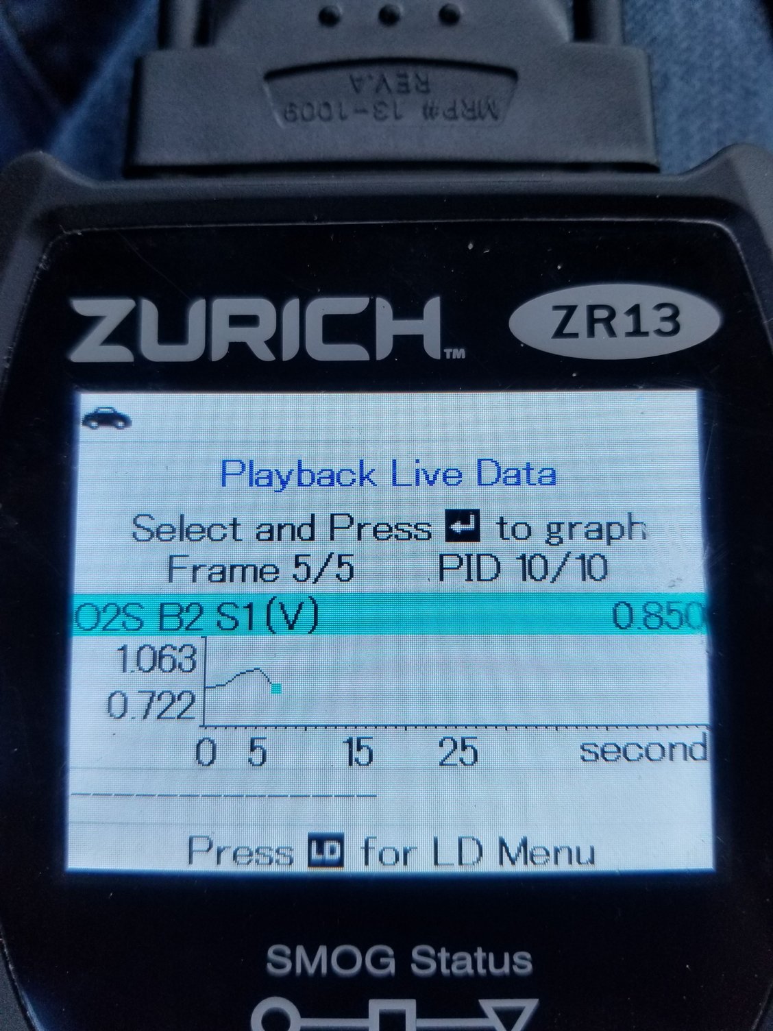

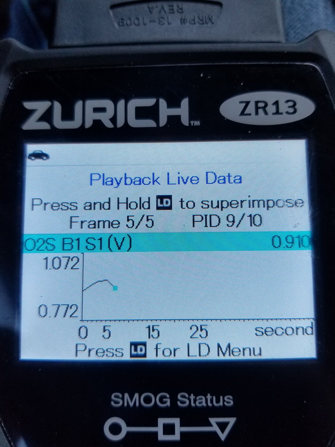

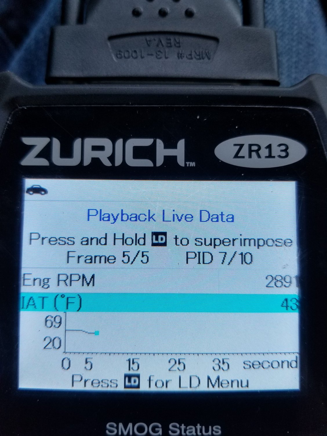

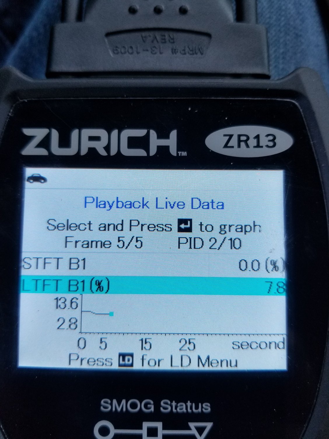

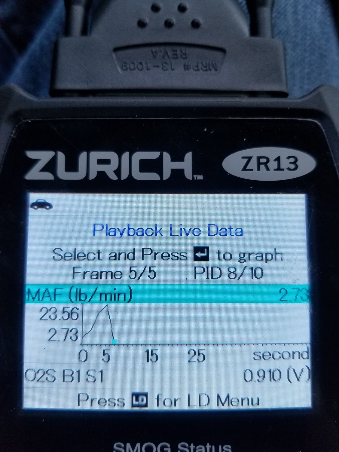

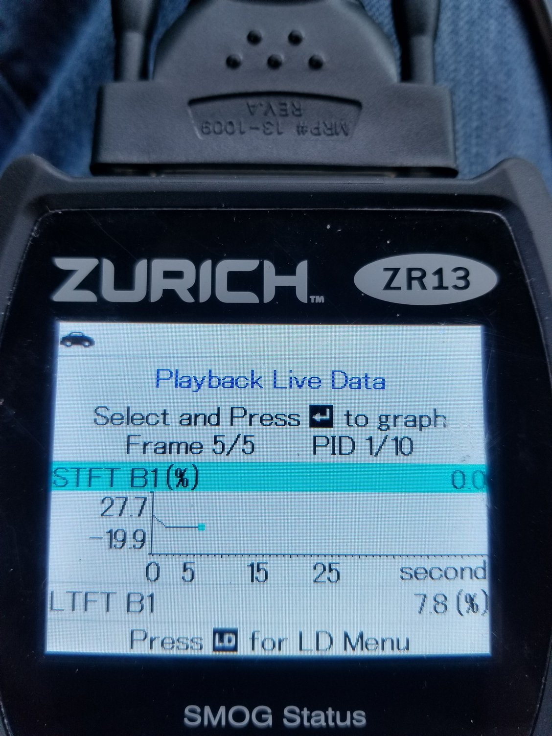

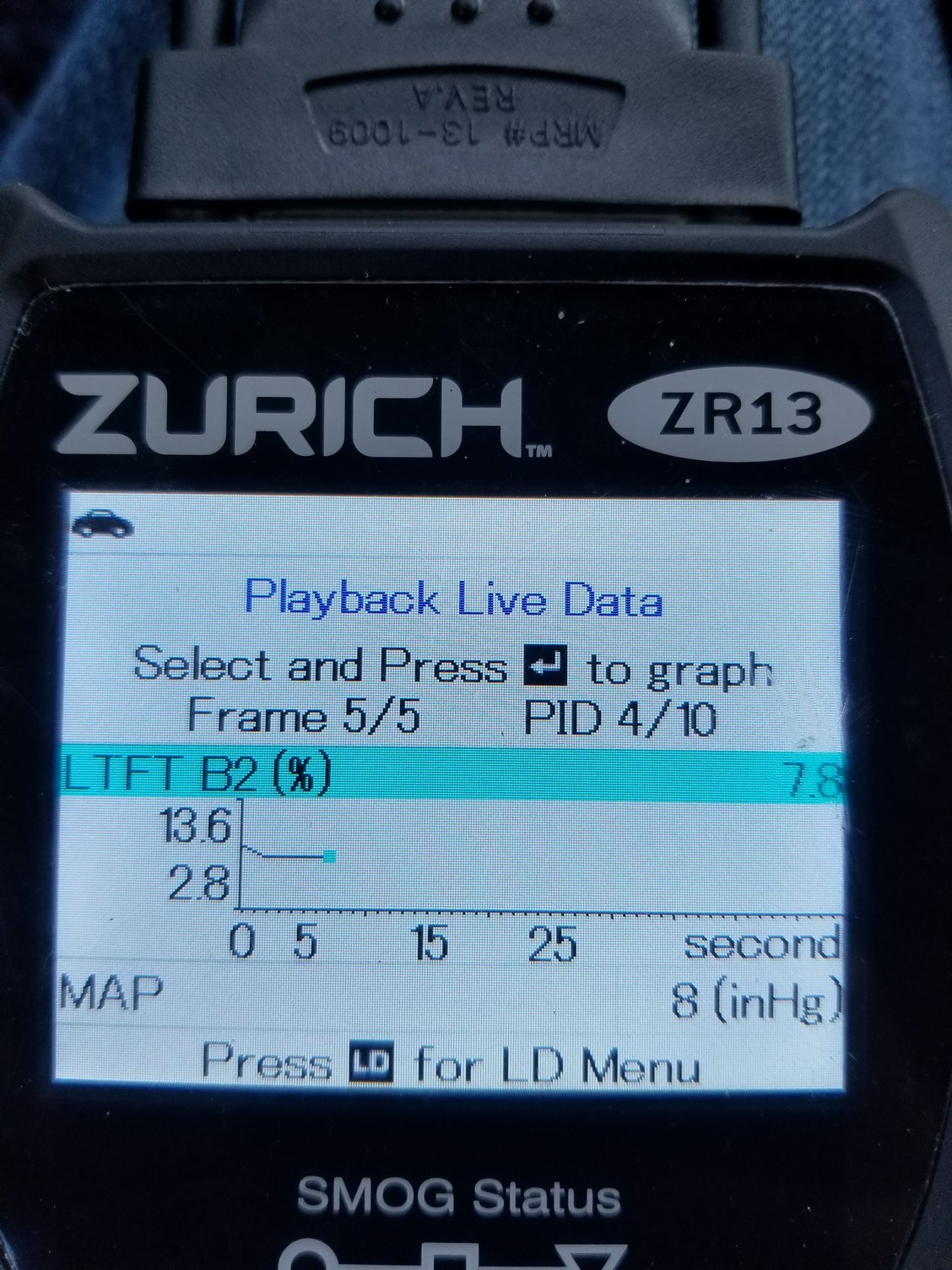

Just did a wot run up to the 1-2 shift. I'll have to go back and upload the graphs but here's some numbers.
Short trims were at 0% throughout the run.
The MAF started at 73g/s and went to 139.4g/s, then ended at 178g/s at the time of shift.
O2 #1 started at .9v and went to .925, .94, and was at .945 at the time of shift.
O2 #2 started at .86 and went to .87, .915, and was at .935 at the shift.
Old Dec 20, 2020 | 01:42 PM

chuey_316 is on a distinguished road
Old Dec 20, 2020 | 03:31 PM
