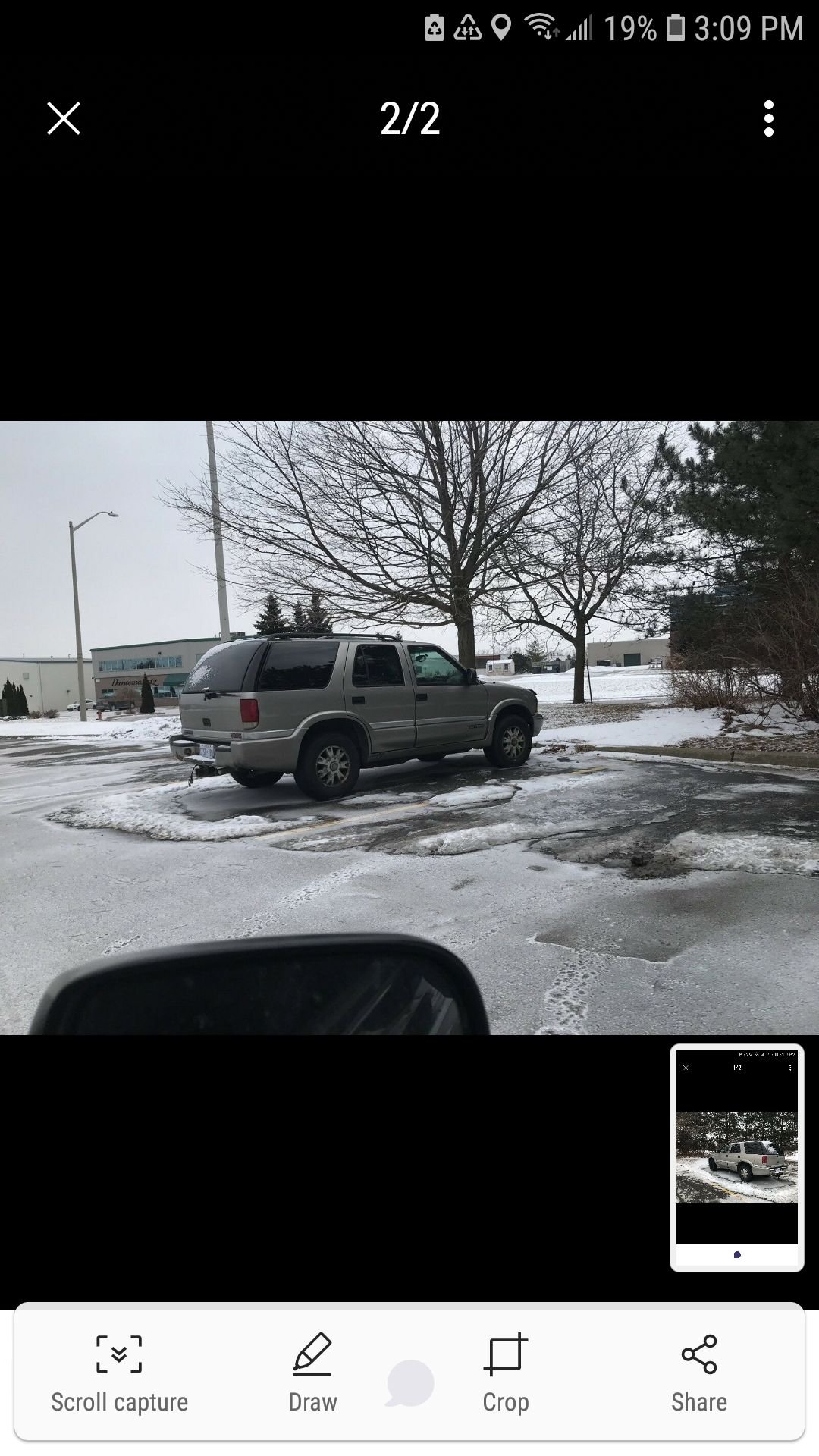

So I finally met up with the jimmy today. Everything looked decent, not as good shape as I wanted but darn descent for 400$, I'll be bringing it home tomorrow. And starting a separate build thread for it.
but here she is. A little body work but nothing too major, p0302, alternator, maybe a battery if it doesnt charge, tires, oil change.

looks decent outside!! Congrats!
