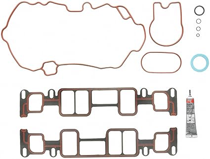

I think you need to be more specific Captain so you said there is do's and don'ts but I must have thought you said do the don'ts lol cause that's what I did. I didn't use the Felpro Gasket but not because I didn't want to take your advice. Only because when I ordered the spider injector gasket when I first did the spider injector I could only order the whole intake gasket set so they came with it and I already had them and since I'm on a limited budget I just had to use what I already had. They were whatever NAPA gives you when you walk up to the counter and ask for the intake gasket set for a 99 Blazer 4.3

Captain Hook's Avatar
Joined: Mar 2009
Posts: 8,453
From: Belleville, Michigan
What did it look like?
This is the MS98002T. It has a metal frame sandwiched in rubber: http://www.carid.com/images/fel-pro/...s/ms98002t.jpg
This is the MS95817. It has a plastic frame and silicone seals: http://ecx.images-amazon.com/images/...eL._SX425_.jpg

it looked like MS95817 BUT BLACK PLASTIC WITH BLUE SILICONE OR RUBBER

That's the OEM style Prone to leaks.
