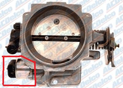

So on my 2002 Blazer LS 4.3l I cannot seem to find the IAC Valve. i know it seems stupid, but even with the Haynes I can't find the thing.
in the manual i think it may be showing pictures of the 2.2 because everything looks completely different. Does anyone have any pictures with the IAC labeled or know where I can find one?
I appreciate it guys.

Here it is outlined in red:
Attached Thumbnails I think I might be blind...IAC Valve? 02 Blazer LS-17113530.jpg

Thank you very much, so do I need to physically take the TB off to get it?
Old Apr 2, 2012 | 08:44 PM
xgiovannix12's Avatar
Posts: 5,962
From: Summit Ny
nope you dont .... It should be 2 screws and a plug
