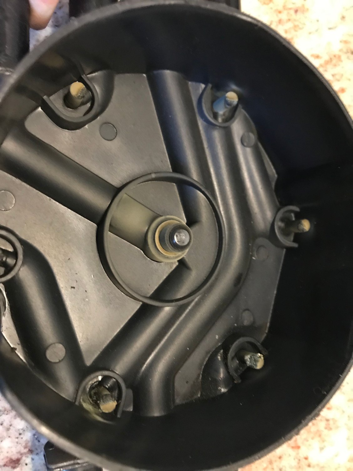

Finally today I removed the cap and rotor.....just over 7 yrs and 70k miles.....what ya think???

Originally Posted by LannyL81
I did pull all the plugs; all looked the same; so that is good.
Beyond shot, by the looks of it you’re lucky it still worked.
I’ve made a routine of changing my cap and rotor every year during my spring oil change.

Gee....me thinks I may have found the reason for the somewhat rough idle......
Going to be replacing these more often after seeing this.
