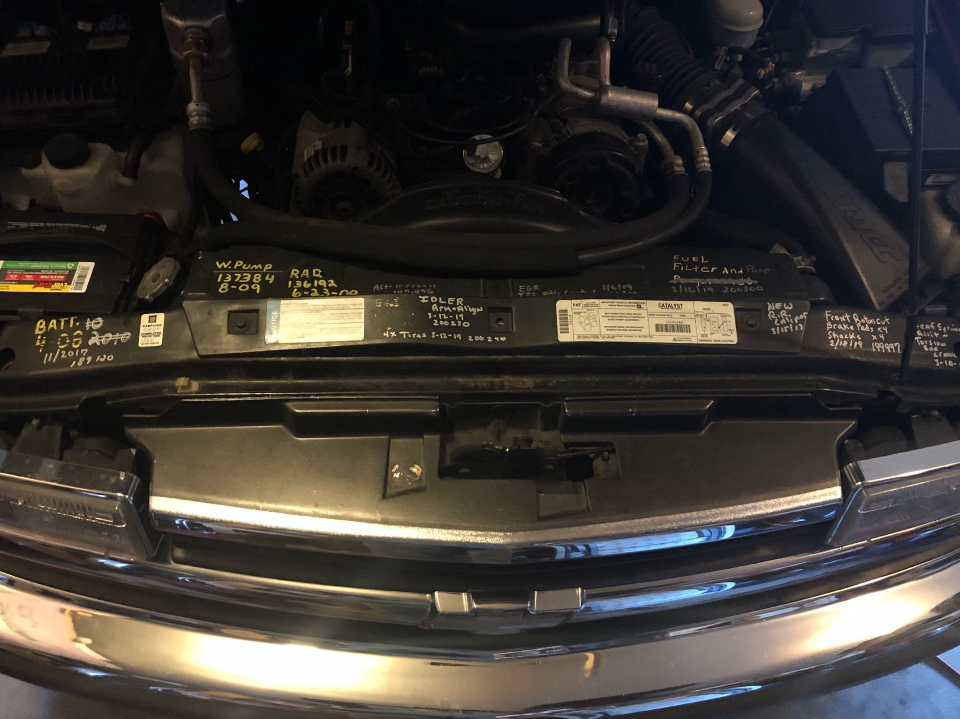

Oh, the fuel pump was replaced not because it was faulty, it pressure tested fine. I replaced it because the seal between the pump and tank was leaking when you filled the tank and I did not know prior owner had cut access to it from interior. So according to notes under hood it had almost 100k miles on it and I was replacing seal, dropping tank, I felt replacing before failure a wise precaution along with filter.
Prior owner made notes of repairs under hood with paint marker pen, I liked the idea so continued doing it, my notes are in silver.
