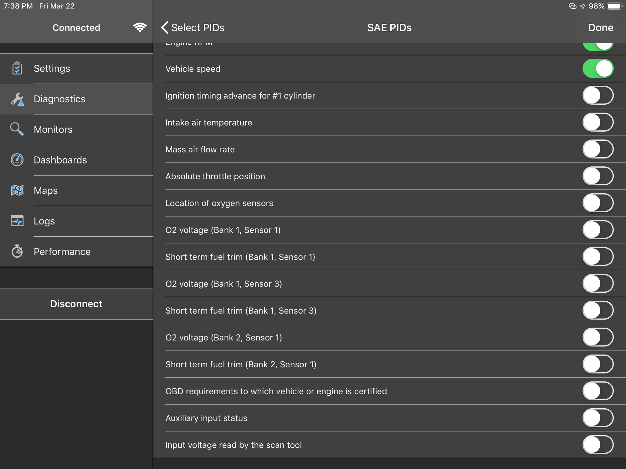

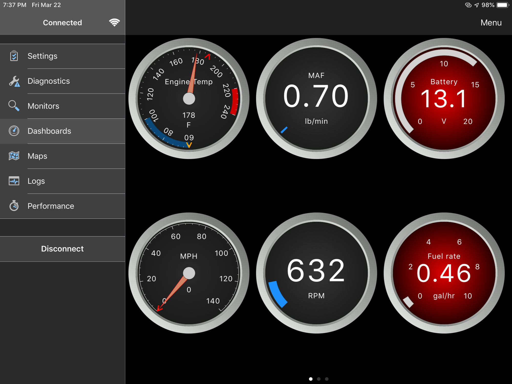

Ok, test app. Dose not seem to need any extras or at least none are available for gm. Lots of features and options. Works smooth as silk on both iPhone 8 Plus and IPad gen 6. I took several screen shots and resized small for space. Let me know which features to test and graph. WIll go from there. So here are the screens shots from IPad, resized.
Base default
Options for that page
Selectable PIDs- page 1
Page 2
Report choices
No GM extras? Either not needed or unavailable

I double checked. No extras for gm to buy but a bunch of PIDs for GM that can be selected. No clue what all of them do. I was playing with measuring fuel trims. Bank 1-2 high low but options I’m unsure of like how long to test (30secs/60etc) should I overlay all as one or separate 1 from 2. Smoothing on or off. Sampling to pid or asynchronous. As far as cam test would need to have idea how to test then see if I could. At parents in Chicago burbs currently helping dad do a few task. Blazer made the 200 mile trip ok. Fuel mileage a bit lower than expected but that’s for later. Let me know.

Default Data from IOS ODB fusion app
Not found a way to have it display quite like that. Can graph but only allows 4 items at a time to graph. Gauge wise can do it like these.
Idle in park- hyway and local ran so hot
After hyway on local roads- cruis set for stable speed/load
On how, cruise set stable speed/load
Took several snap shots, number bounce a little each sec. These seemed a good avg representation of values.
Graphing is only the 4 values at a time and can overlay all 4 or separate like say bank 1 from bank 2 along with choice of colors, time of graph, smoothing or not and link to pid or asynchronous. Those GM extras- these are what I see and menus but no clue which are ok to even use.
User defined PIDs
Go to import built-in PIDs
Scrolled down to GM (ford was above) a lot to choose from but clueless what they all do, only logical guess on some.
Scrolling down, 4 pages worth in total
3rd page worth
Last page. Guess would need to know the ones that applied to your particular car.
