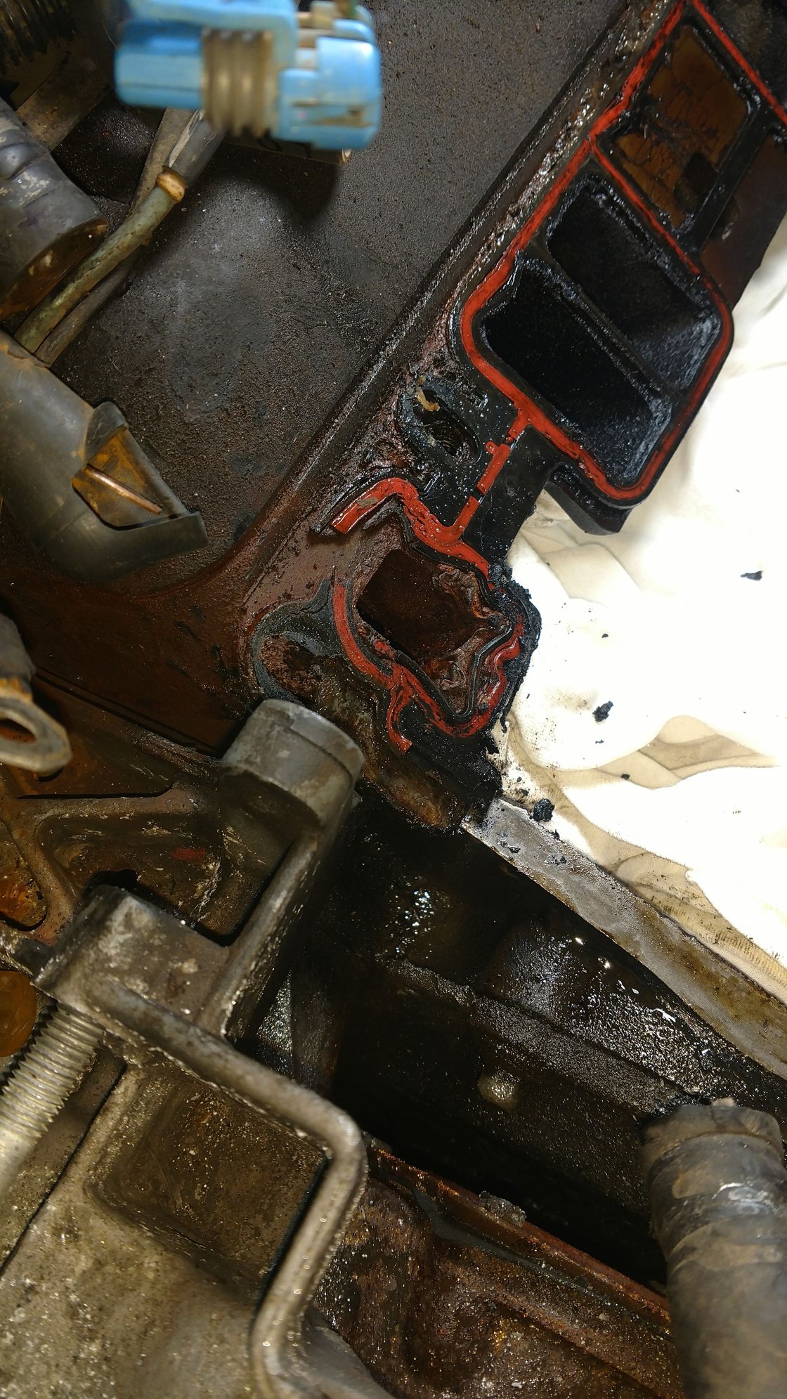

. I finally started on the intake gasket guys, sorry it's been quite awhile since I started this thread. I'm sure glad I read some of your guys' last tips before I really began cleaning this thing. One question, what if I get a little gunk or grease in the ports? Will a vacuum suck it out just fine? Thanks fellas, Seawolf74

Are you referring to the intake ports? If the gunk is soluble in gas and is organic it might not be bad. I would want to keep anything that could go "crunch" out of them. I did my absolute best to plug the intake ports and then used my shop vac to suck out any loose bits/particles.

BTW, looks like your LIM gaskets could have gone for another 200,000 miles easy!

I wish!
