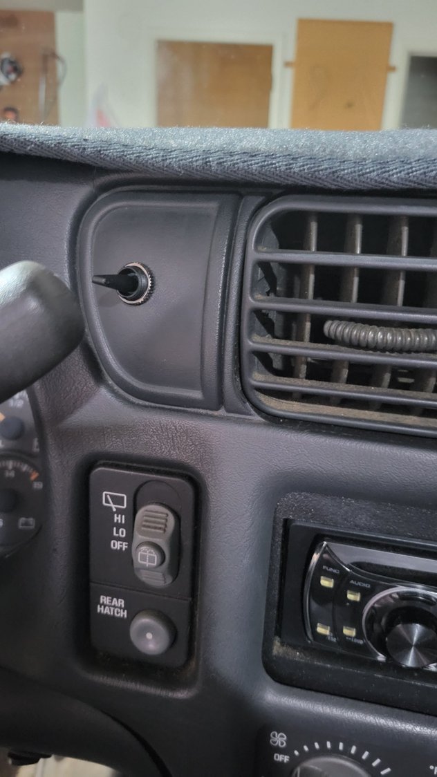

I have a cousin that is a redneck genius and he worked out a workaround. Got a toggle switch and soldered the blend door motor to it and I mounted it in the cover of where the 4x4 controls would be. Up is hot and down is cold. It took 6 seconds to go through the full range so I just have to make sure I don't push on it for too long.
This is great, made me smile.
