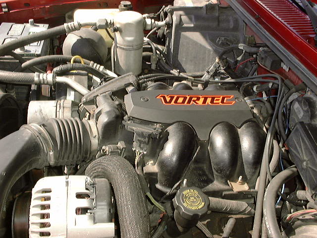

Yup, all 94 "W" engines are CPI, (also referred to as CMFI, central multiport fuel injection) and look like this:

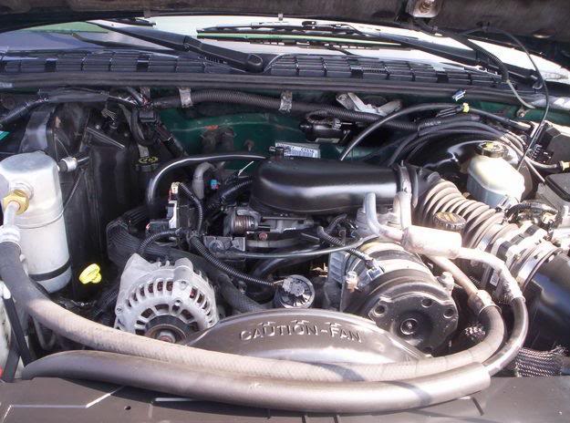

1996 through 2002 "W" are CSFI, and look like this:
2003 through 2005 are VIN "X" and look very similar, but they do not have an EGR valve.

So what you are saying is I can only replace the spider with another spider. I was hoping to get that upgrade. (unless it's a programming issue and you could reflash it somehow)

That is correct. See post #24.
Your 94 has one injector, (2 wires) and it is batch fired, (fires whenever ANY cylinder calls for fuel). The injector fires 6 times for each two crankshaft revolutions. 1996 and newer has six injectors, (12 wires) and each injector fires sequentially with the firing order. Each injector fires one time for each two crankshaft revolutions.
To upgrade your system, it would require a 1996 or newer engine, PCM, fuel pump, engine wire harness, etc, etc, etc, ton of work.
