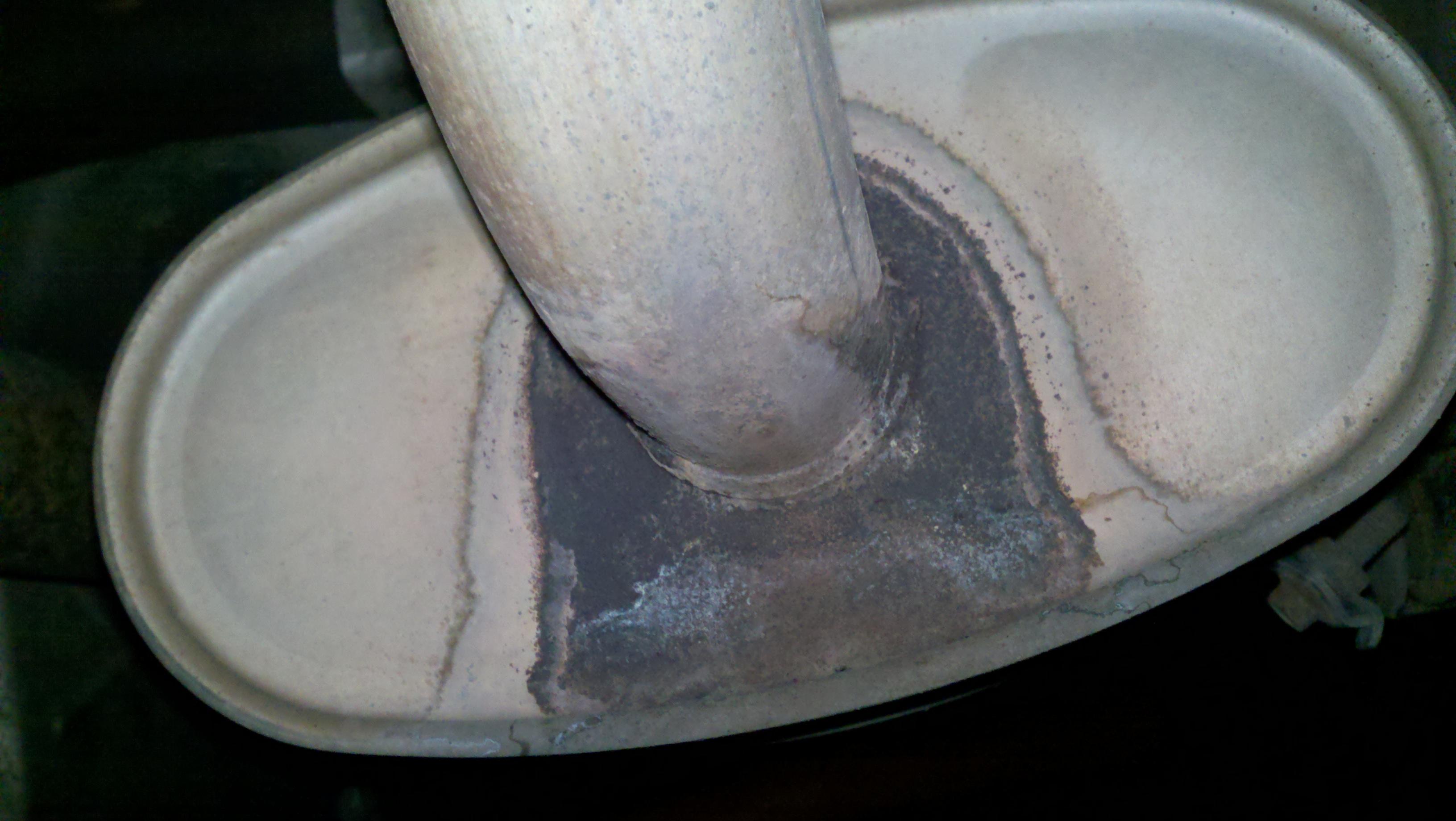

Hey everyone. I seem to have a muffler that has rusted where the tailpipe exits to the bumper. It leaks water when the engine is running and was just started after a cold start from a hidden hole in the seam between the pipe and the muffler. I have reason to believe that exhaust gasses might be entering the cabin of the truck and that it might be from this as there are no other leaks or noise or smell. Can I fix this with muffler repair putty that is in Advance Auto? Or do I need a muffler?

If you put putty over the hole, the water that is supposed to exit from there will instead collect and pool at the bottom and rust from the inside out.
Man, I understand preventative maintenance, but now you're finding things to 'fix' that are supposed to be there. Do you have Auto-related OCD?

Yes, without degrading you as a person, that hole is supposed to be there. Most modern mufflers have them. It's called a weep hole. Wasn't trying to knock you with the OCD comment, just seems you worry more than three people combined sometimes.

Yup, its a weep hole they all are correct. It is there to let the water drain out to slow down the rotting out of your muffler. Back in the day when I was working for Midas I had a customer come in and say he put a self tapping screw in the hole to keep it from leaking, in the end he had to replace the exhaust because after we explained to him what the hole was for he removed it but now instead of it being this size * it was this size *(not to scale) but you get the point. He ended causing an exhaust leak sound.

Oh ok. Thanks. So that rust and water is normal for this.
I am not hearing anything or smelling anything obvious in the passenger compartment that would indicate an exhaust leak, but since I was getting headaches, fatigue, tiredness on longer trips (not longer than 3.5 hours of driving, interrupted by frequent stops for gas and food. On long trips, I leave very early and stop often.) even when I get alot of sleep the night before (I also have some soda and sugar and that doesn't help much) and it seems to mostly resolve itself when I open the windows, I was thinking that I had a leak somewhere causing low levels of CO to enter the passenger compartment. This seems to happen on most trips, the most recent being Sunday night on the way back from northeastern PA going to the Capital Region of NY State (3 hours) and other shorter ones that were 2 hours long. Could I have an exhaust leak somewhere else that is common on the S-10 series?

House hold carbon monoxide dector put it in your car it will pick up any carbon monoxide leaking in to you cab area
If it gos off you should do 1 of 2 things open your windows and air out the cab or get out and run j/k
Also the soda sugar crash dont help try some power-aid water and fruit or veggies
