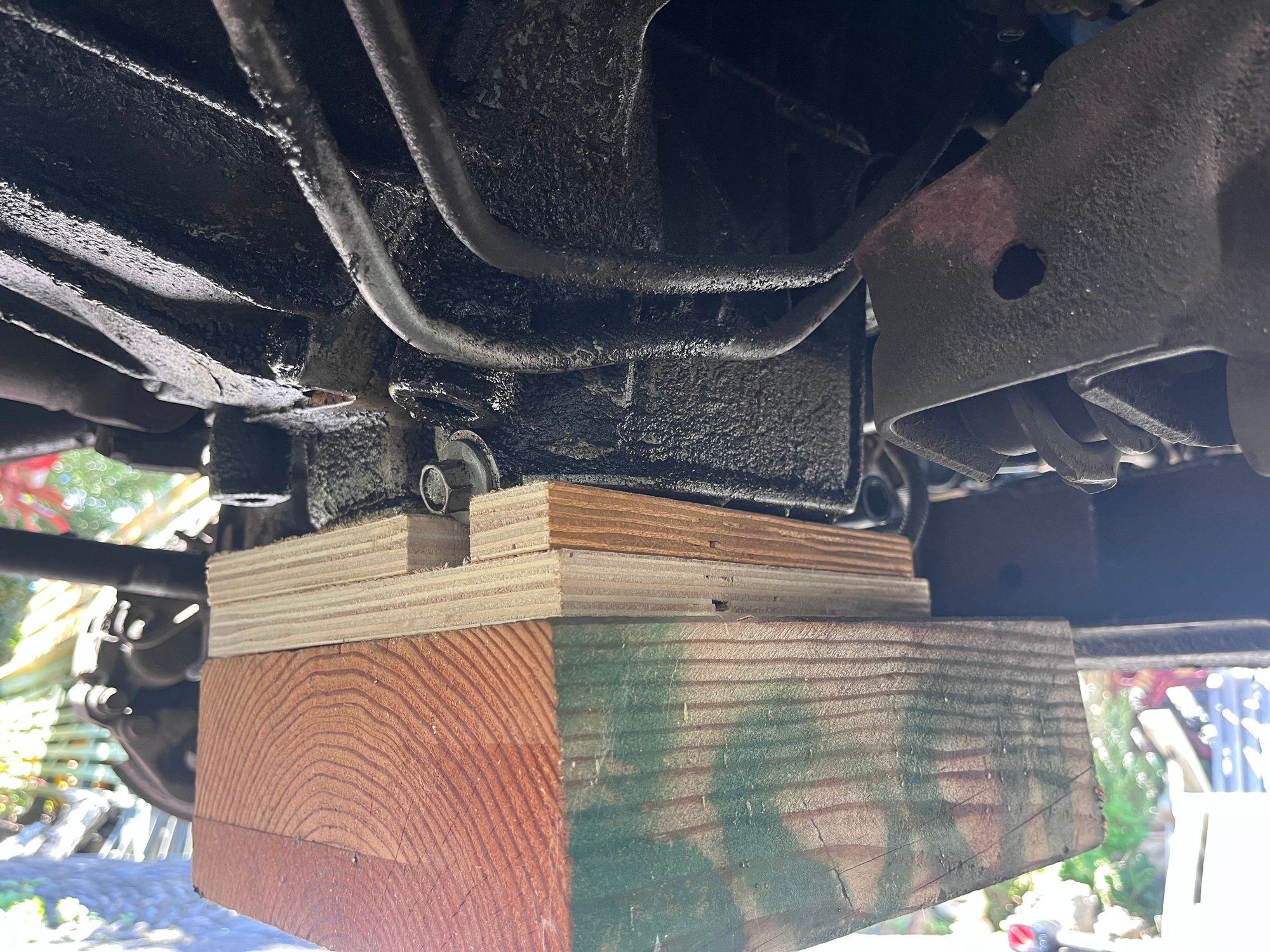

Hello Forum,
I attached a photo to get your opinion on lifting the engine during a drivers side motor mount replacement. I know there is a lot of posts with guys lifting the engine to gain access to the motor mounts. Do you guys think it would be a problem to lift the engine with the passenger side mount still attached since it does not need to be replaced? Has anyone heard of someone cracking the oil pan?

I lifted my engine that way to replace the passenger side mount. I did my best to only lift it enough to get to it to avoid damaging the pan and the other mount.
I found I had to detatch the rear mount too to get enough freedom to move the engine.

I finished installing the mount on the drivers side. The passenger mount is is okay for now. Changing the drivers side mount was not a fun project. If anyone has and specific questions please PM me and would be happy to answer them. There are a number of good threads and YouTube videos to learn from.

The bad news is the passenger side is more of a PITA. The transmission cooler lines are in the way and they are kinda fun to move out of the way.

In order to replace my passenger side mount, I had to go in from the wheel well and also from the front. I also had to buy a set of flex-head ratching box-end wrenches.

The Factory GM manual says NEVER LIFT BY THE OIL PAN. ITS NOT LIFTING JUST THE ENGINE!
Theres a lift point on the front of the intake manifold for that purpose...
