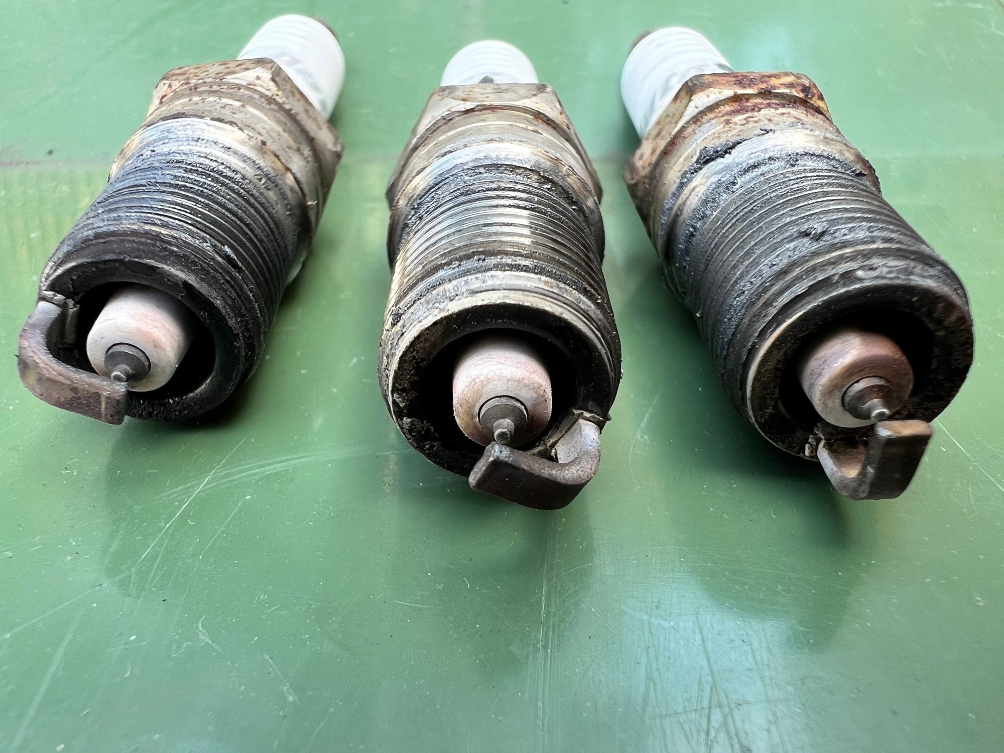

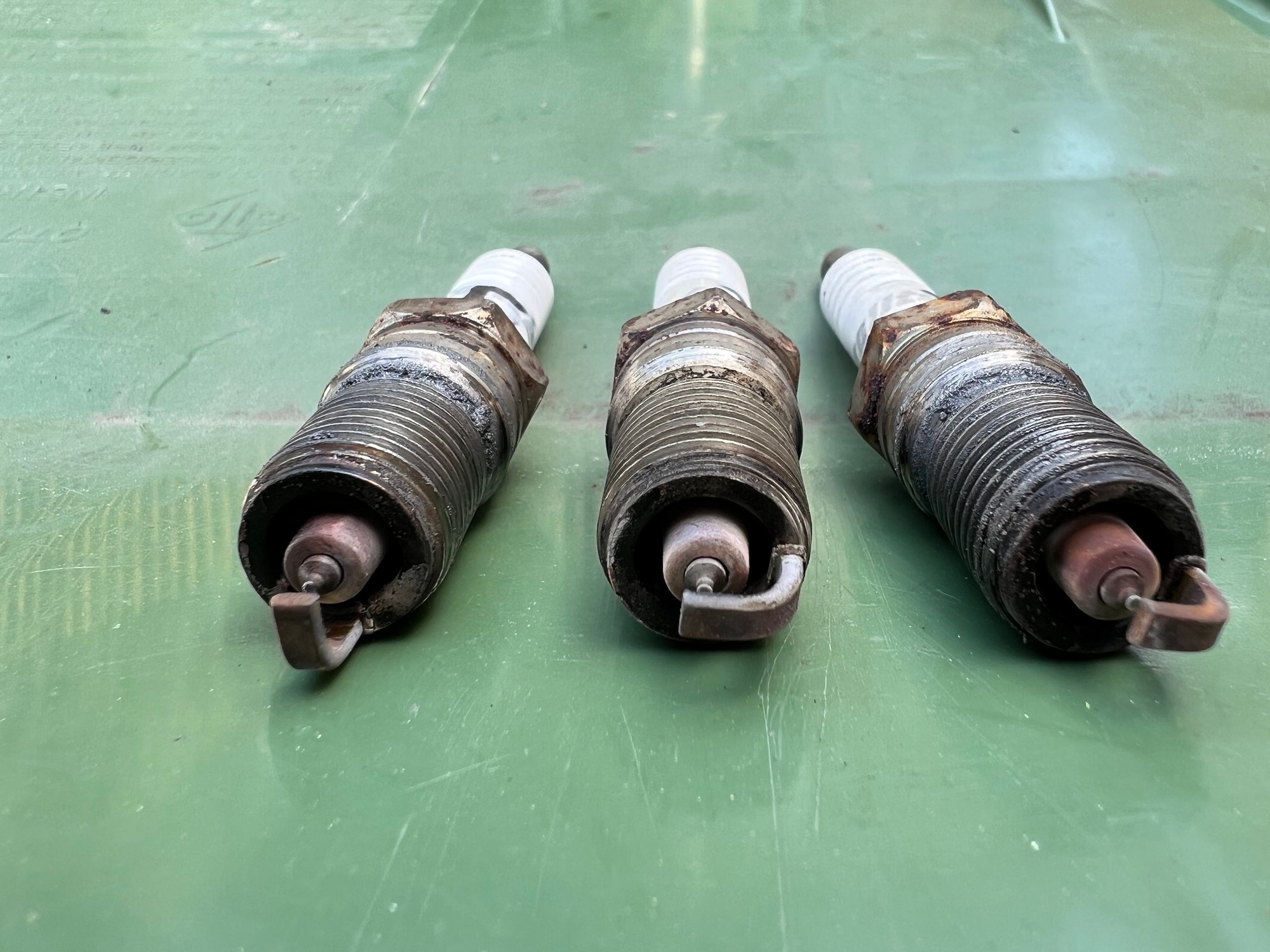

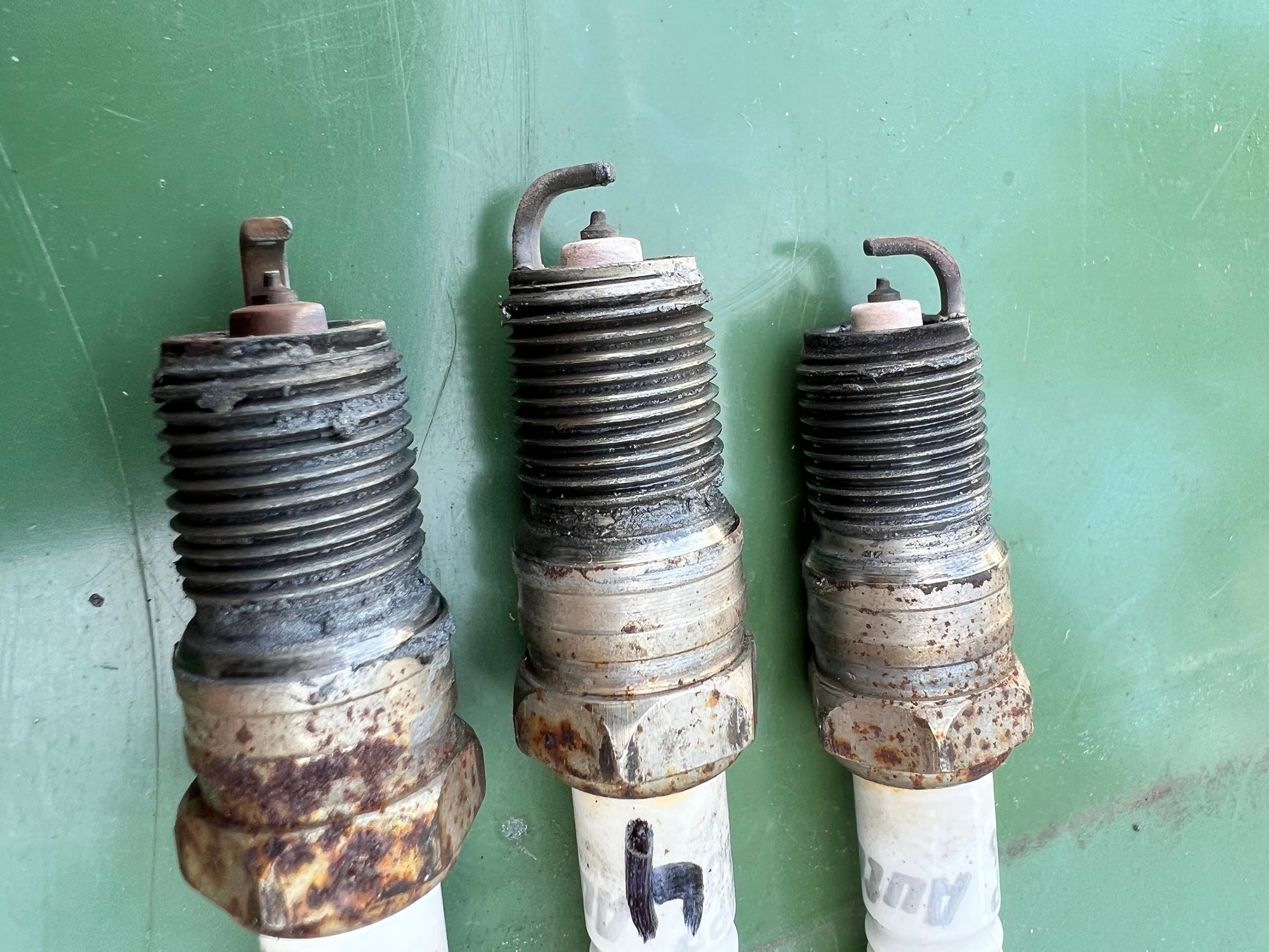

Default Pulled plugs.
all plugs are dry, no oil build up. I thinking it’s running lean? #2 plug wire wasn’t fully connected so that may explain #2 misfire. Will install to different cylinder positions and see if the misfires stay at #1/2 or follow to new cylinder.

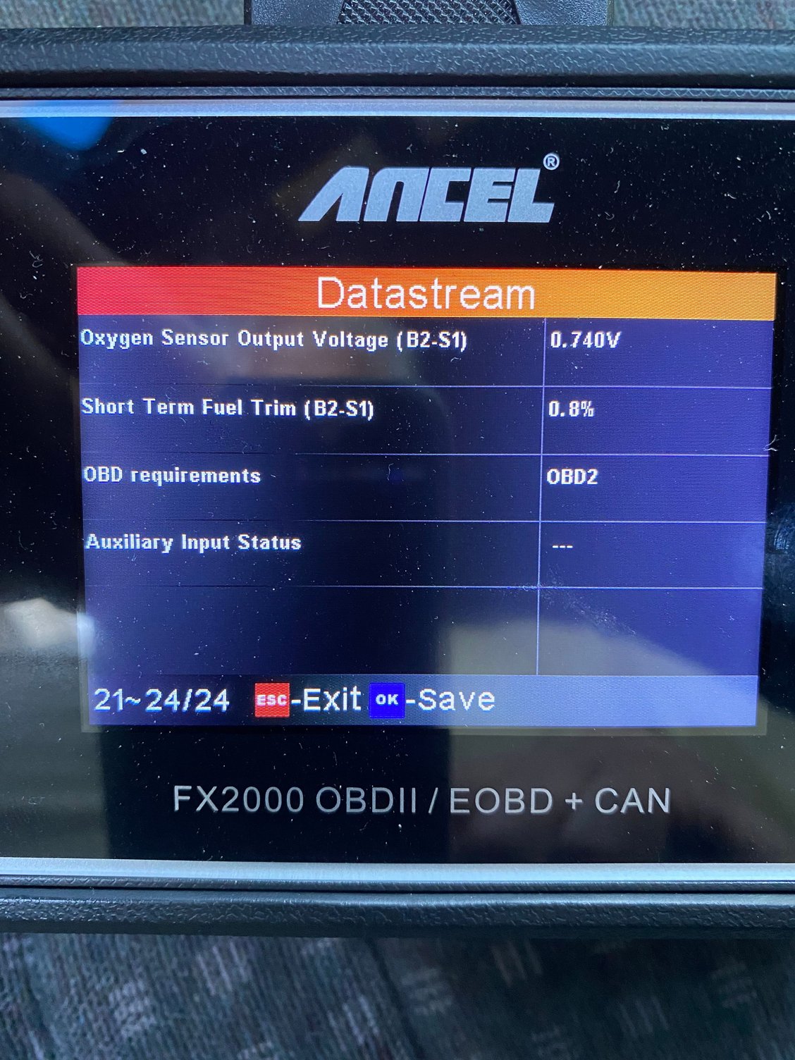

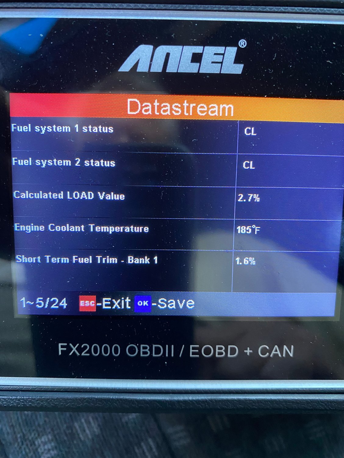

Drove yesterday, still gets po300. New plugs installed, #2 is the main misfire, up to 90 misfires at a time.
Old Jun 21, 2022 | 11:57 PM
  #28
Weatherj's Avatar
Joined: Nov 2018
Posts: 61
From: Montgomery Al area
Weatherj is on a distinguished road
Default Data pull
Still working the mis fire issue, new plugs helped, data now is showing #1 with just a few 5/7 then zero for a few seconds and repeat. Now#2 seems to be the heavy hitter with up to 96 misfires,pause and start over. I found a misfire history tab that showed #1 at 478. #2 at 359. #3 at31, nothing for #4-5-6. Now what?
