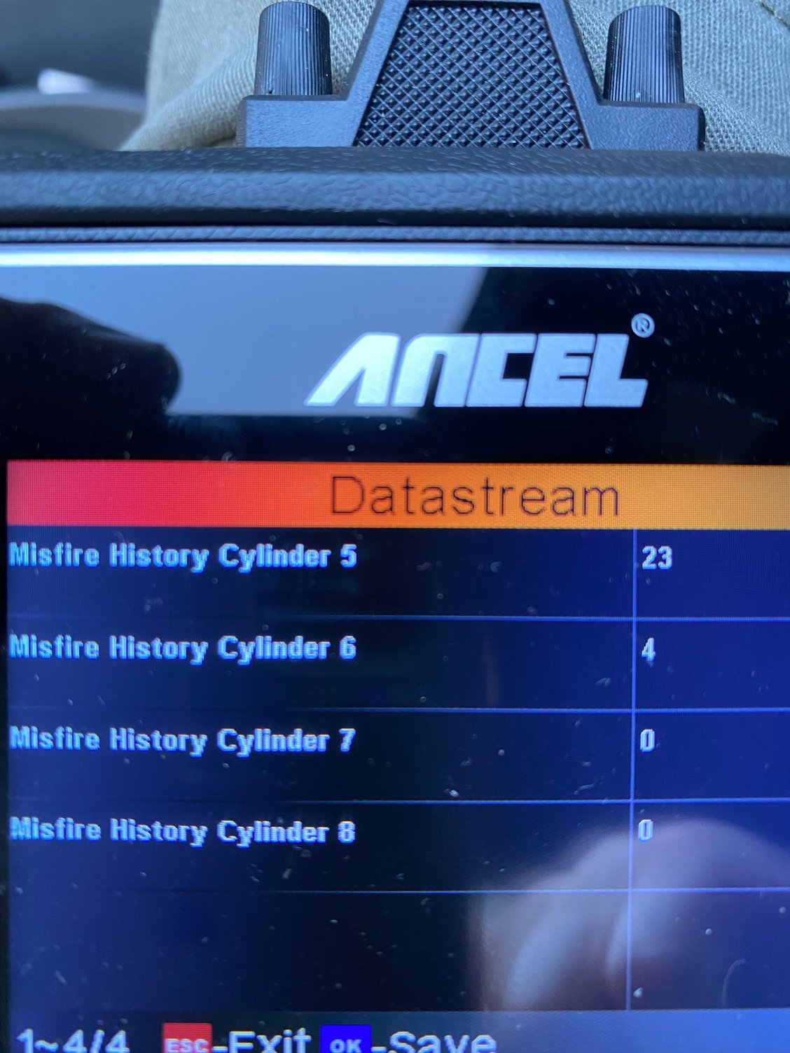

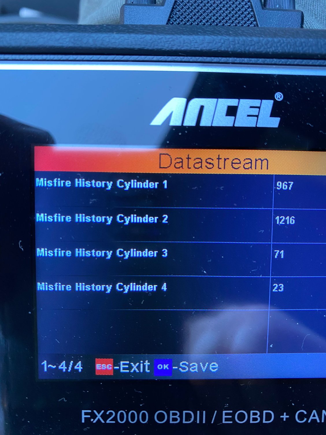

#2 is definitely the misfire poster child. 1/3/5 have very low count misfires. I will get the compression test for #2 , ohm the new plug wire just in case it’s bad. I did see a data pic for advanced timing for #1 cylinder at 17.5/18,6, is that the CPM retard? I now have a decent scanner so if you need any certain data I’m more than glad to gather what you need. I did discover the rear tiny screw for the cap was too loose so I cut new threads in both to hold the cap secure, unfortunately it had no effect on the misfires.

Because you have a high count on a single cylinder I would concentrate on the individual cylinder causes:
Ignition
Injector firing
Mechanical problems (compression)
George

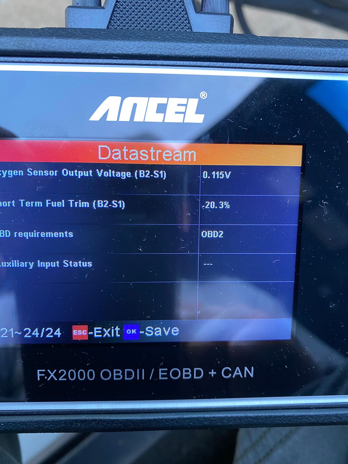

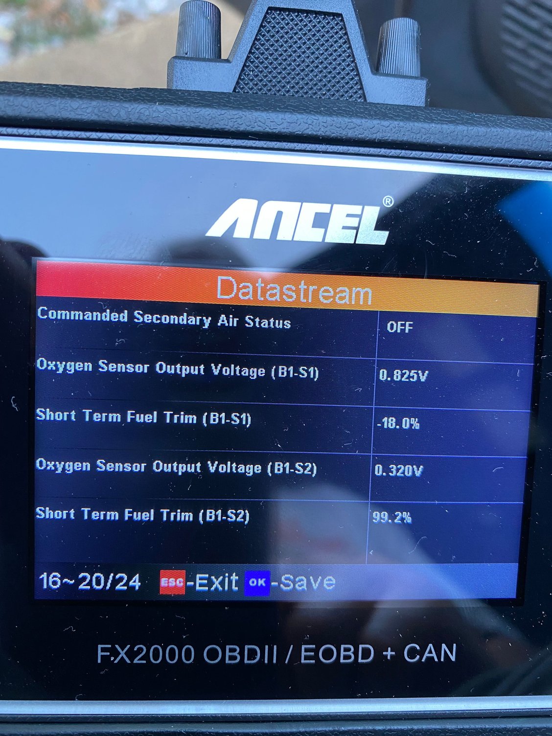

I just noticed those sky high short term fuel trims. They need to be captured with long term trims:
https://blazerforum.com/forum/2nd-ge...-trims-102906/
Also, can you graph your two precat O2 sensors (B1S1 and B2S1)?:
https://blazerforum.com/forum/2nd-ge...82/#post733375
