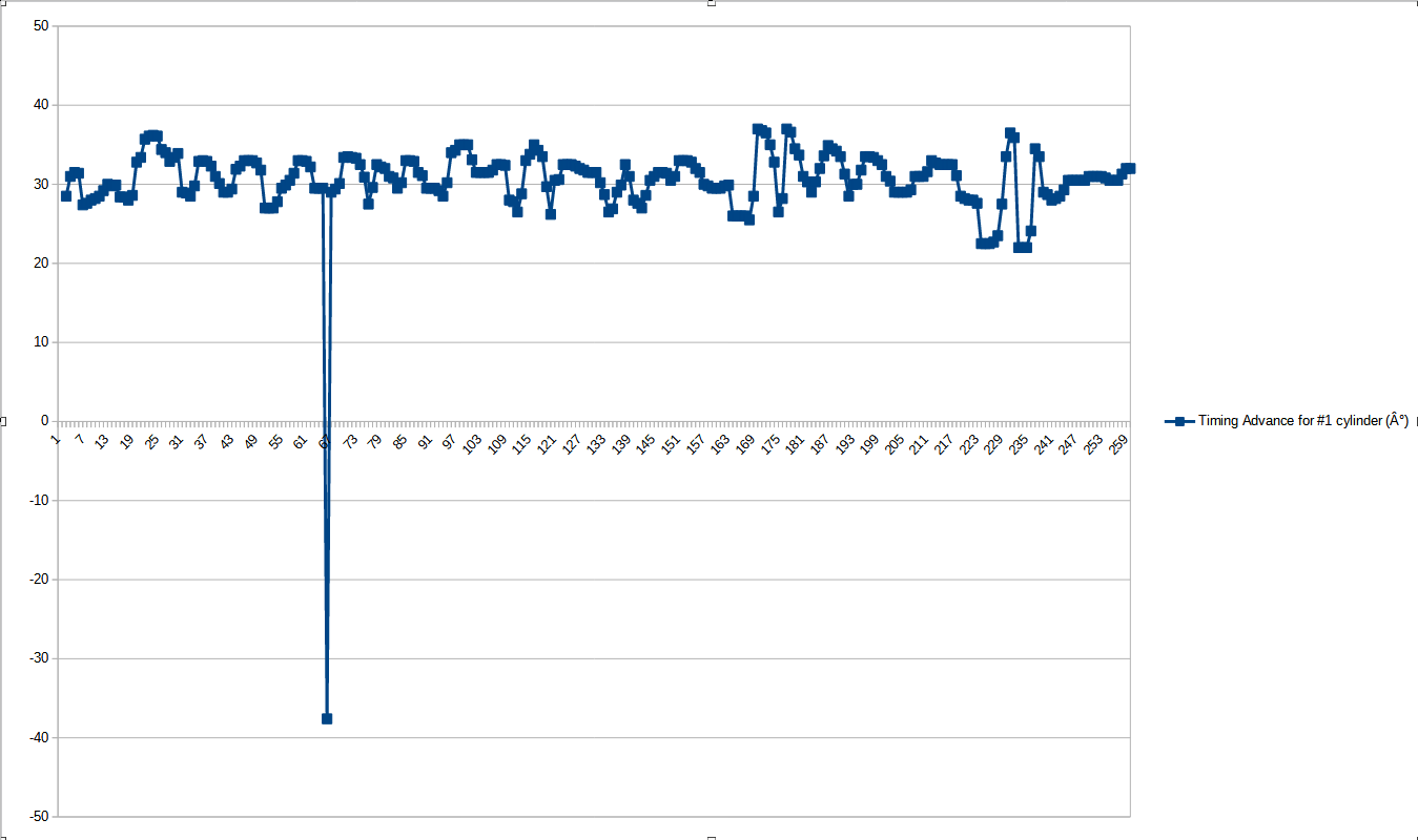

I've looked into other things that could be causing performance and MPG issues, and one thing that kept coming up is ignition timing.
I do have quite a bit of engine vibration at idle and some while under load. I watched some videos from Scotty Kilmer and learned that the timing advance / ignition timing will cause vibration.
Using my BlueDriver, I gathered this data from a 5 minute drive on smooth road with cruise control set at 45 MPH. The timing advance seems to be all over the place (see graph below).
Based on what I understand Scotty to be saying, the timing shouldn't be bouncing around like this at a constant RPM.

A single fuel trim number is of no diagnostic value. Please read my tech article in my signature and report all 4 values. Trends also have value but again, all 4 numbers.
You have control over CMP retard which is adjusted by rotating the distributor. The engine computer decides overall timing. Measure CMP retard and report back. Les can help you get this capability on the cheap (ish).
That O2 sensor graph looks OK at the voltage limits but I cannot asses the switching frequency or rise and fall time. Play with the horizontal scale and look for around 1 hz at idle and 100-200 ms switching time.

I have a lot more data from that 5 minute drive at 45 MPH. It's just a real pain to make a graph of each endpoint from the CSV file BlueDriver exports.
https://docs.google.com/spreadsheets...f=true&sd=true
I'll look into measuring CMP, though my current concern is the timing advance values bouncing around like this at a steady RPM. Would that be CMP related?

Red Valor, FYI 1 data point every 1.3 sec can be problematic when trying to track quickly oscillating data like fuel trims and o2 sensor voltages. I always got about 30 data points per second back from the PCM on my BAFX Bluetooth OBD2 adapter to be split among the monitored sensors, and I would limit plots to only 2 or 3 sensors at a time. Not sure what you Blue Driver device is capable of for data points per second.

Yeah, I don't know why it's setup this way. I can't find a way to change the polling rate, so I guess I'm just stuck with it. This behavior makes it really difficult to work with when you want to track all fuel trims and O2 sensors. The BlueDriver app itself claims you'll get better quality data logging no more than 5 sources at a time. I only picked up the BlueDriver because it seemed like the best inexpensive option at the time that can read system modules for fault codes because I've been battling ABS issues for a while now and I still can't find the problem.

Probably the only way to increase the polling rate on an individual sensor or two is to uncheck the rest of the PIDs that are selected in "Data Sources". I always found a plot of RPM during acceleration/deceleration to be indicative of good polling...... smoth curve with no steps=fast data rate.
