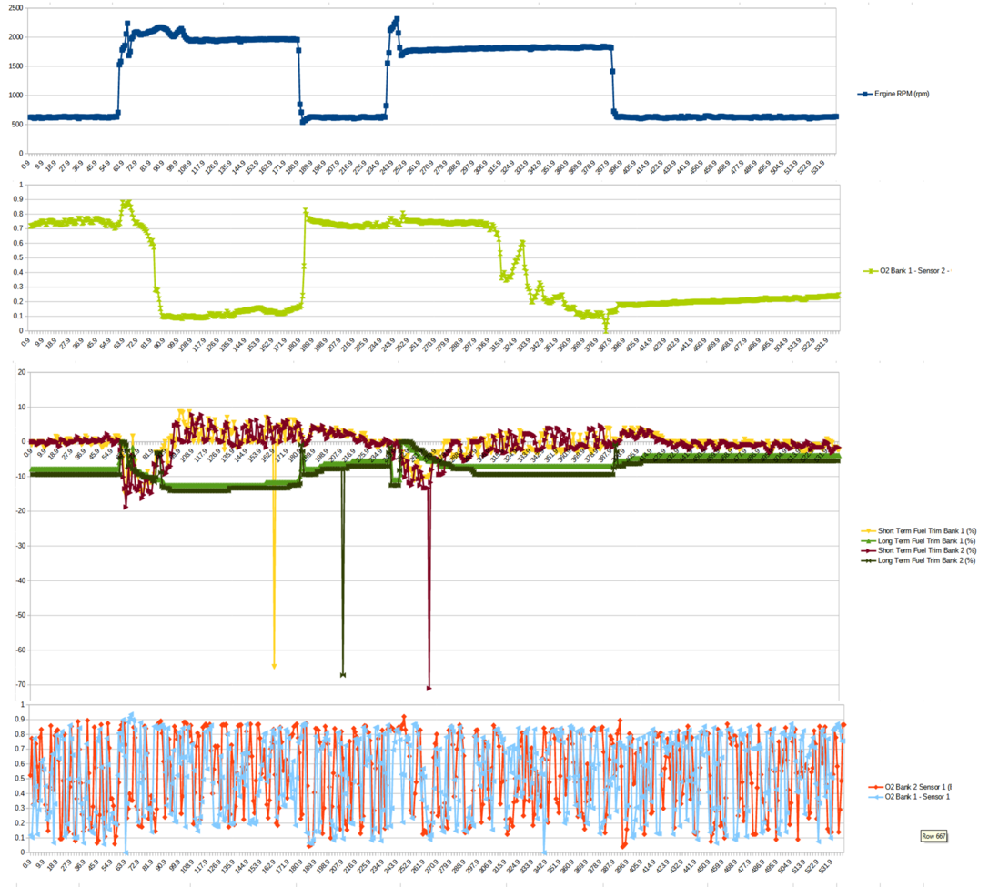

Here's the data I recorded for another thread showing the O2 sensor with everything warmed up.
https://cimg4.ibsrv.net/gimg/blazerf...84f148e38b.png
Does that B1S2 graph look normal? Brand new O2 sensor, by the way.

Those three things can be independent or can occur in combinations. All of these tests that you have discussed address 1 and 2 and therefore some of those tests are not just testing for a restricted exhaust.
A spent catalyst is tested by things like:
1) A post cat O2 sensor waveform compared to a pre cat sensor waveform
2) The pre and post cat temp comparisons
3) An oxygen storage test after inducing an air leak
A plugged cat can be confirmed through a variety of ways such as:
1) Back pressure testing
2) Removing a pre cat sensor and run the truck
3) Vacuum behavior at different rpm's
4) Volumetric efficiency calculations
Yes your performance complaint can be a restricted exhaust but it can be other things as well. You passed the back pressure test and your truck did not run any better with an O2 sensor removed. Did you also test the vacuum behavior to confirm? I think you did a full throttle 1-2 shift MAF measurement on another thread. Your result was low but I don't know the operating conditions. Put that and the associated parameters in to a VE calculator and see what you get. There can be more than one reason for a poor result there but its another data point. I get the feeling that you really want to have a bad cat. Be careful, in problem solving its a bad idea to go into the problem with an assumed cause and winding up closed minded about the data.
