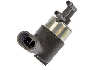

Disconnect and plug the vacuum line at the axle actuator under the battery tray and drive it. If the noise is gone, it might be that the vacuum switch on the firewall is partially applying vacuum to the axle actuator in 2WD, (there should not be any vacuum at the actuator in 2WD, only in 4WD). The vacuum switch is about 2.5" tall located near the center of the firewall, above the distributor. There is one electrical connector with 2 wires in it and 2 vacuum lines attached to it. This is what it looks like:
Attached Thumbnails Metal Clicking sound when out of 4x4-600-10419994wdaxleactuator.jpg
