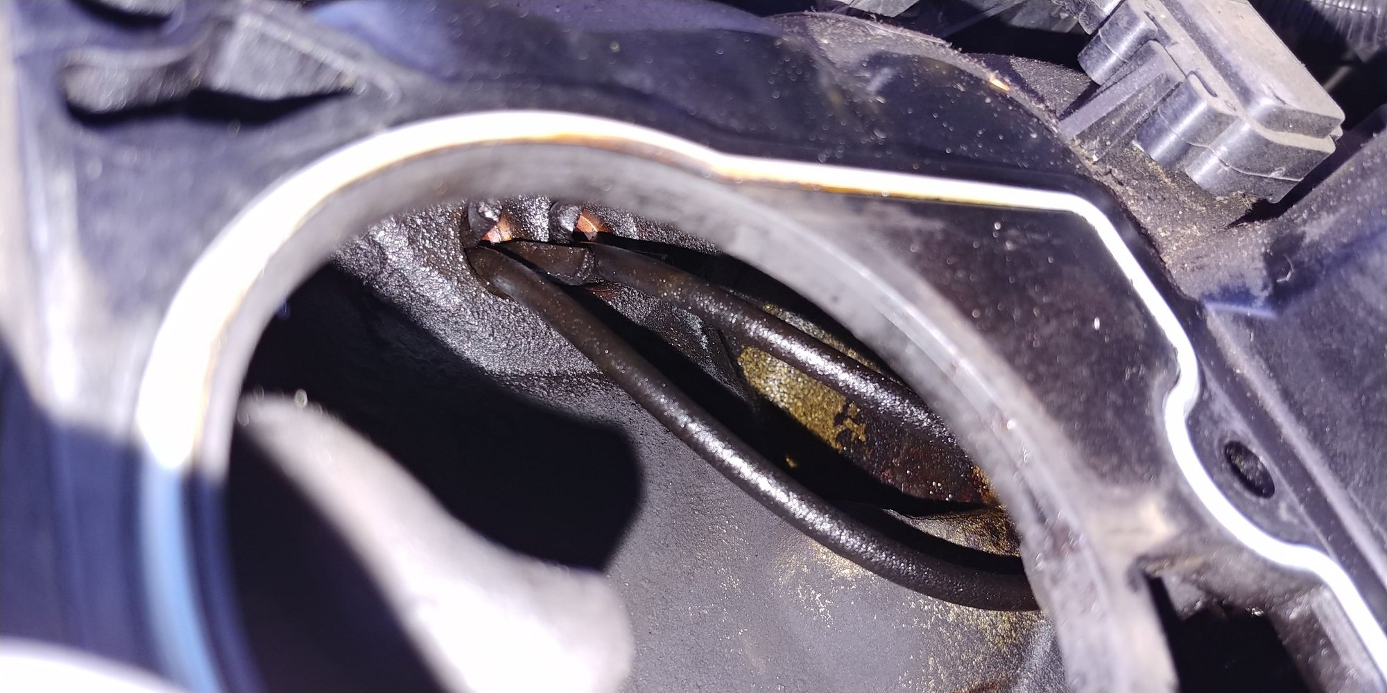

Funny you should mention exactly that. I ran across a post regarding the SCPI to MPFI upgrade on a silverado and made me want see if I could do it to the jimmy. But whether I can or cannot it made me wonder if it was the fuel efficiency issue on this truck even with it's lower miles. I was waiting to get back to my computer to post these pictures I took while the TB was off and noticed the distinctively clean side.
If that is the case, I still wonder why it would clear all tests (except the secondary air) until cleaned the TB..then throw the high idle code, then the O2 code after I get the TPS and IAC replaced. I suppose the IAC could have been stuck more open and compensating a bit for the over injection of fuel witht he extra air then drop the airflow with the working IAC.... but I digress: I assume at least to 2 clean ones I can see are cleaned by the gas or stuck or leaking.. Is it possible to do a MPFI swap on this 2000 jimmy?

This webpage helped me understand what fuel injection systems were used for each year. Vortec CSFI to MPFI conversion
The short answer to your question is Yes. The new style injectors were not used on new vehicles until 2002 but they can be installed on vehicles made from 96-01.
Those clean areas with no carbon build-up are a good clue that you have a fuel leak.
I replaced my injectors when I had the top of my motor apart to replace the lower intake manifold (LIM) gaskets. I was glad I did as I could see where they were starting to fail.
Thanks for the confirmation. I am going to do the intake gaskets while I am in there with the updated fel pro set with the metal mesh as that blazerforum thread i linked mentioned.
