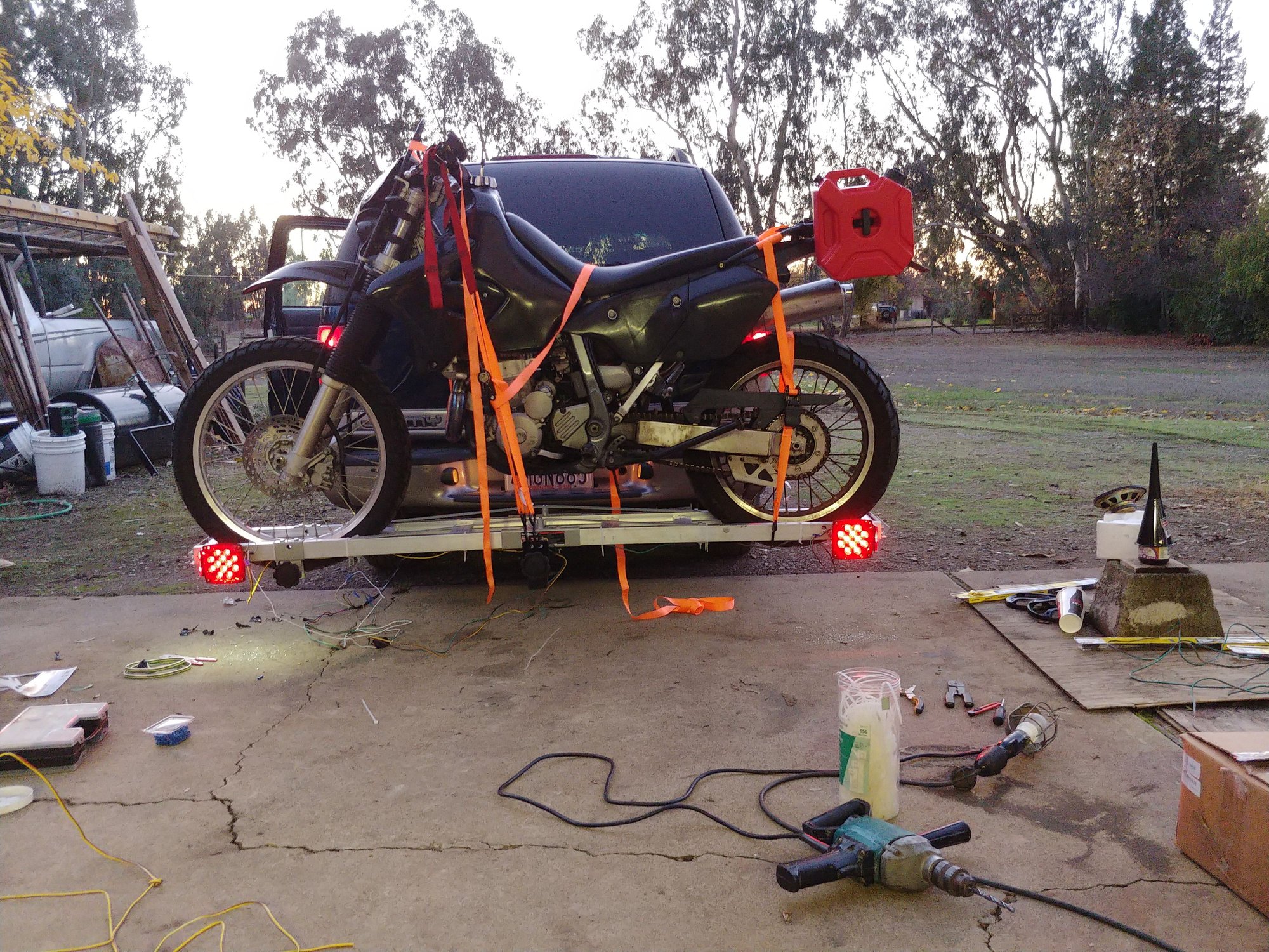

Did you get to work on your door over the last few days?
I haven't gotten to work much at all on mine. Been trying to get smog stuff done, thanks California.
On a good note, no new problems have popped up and was able to get the trailer wiring done and get my motorcycle hitch mount on and wired for lighting as well.

Sorry I haven't gotten back to you. Im having to deal with a no start issue after having the fuel pump replaced. Your hitch mount looks good. Ill try to update after the z is up and running.
