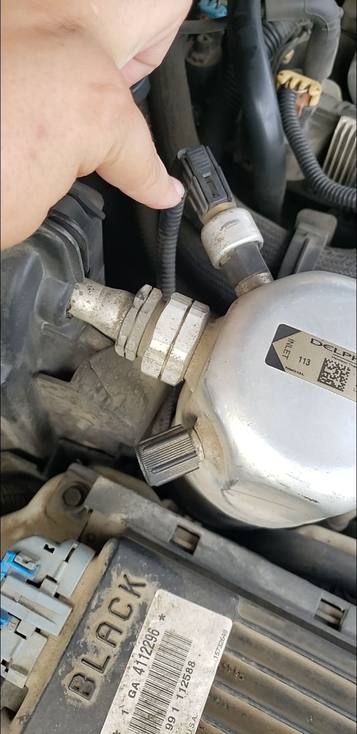

Ok so the point that i am pointing at is the high pressure the other little black piece is the low pressure i pulled the switch of an bypassed to get the compresaor running to be able to give it a small charge to stay running after i reconnected it to the high pressure sensor again also i had to buy a new high pressure sensor the location i am pointing at

The thing that you are pointing at is the low pressure/cycling switch/sensor and it is mounted on the accumulator. There is a high pressure switch but it is 4 feet away mounted on the back of the compressor. You cannot remove the high pressure switch without reclaiming the refrigerant charge first as there is no schrader valve and it would be dangerous to do so.
You are pulling the switch off or you are removing the connector to the switch so that you can jumper the wires inside the connector to the switch?
That entire silver can is the accumulator and it is in the low pressure circuit so that other connector with the small cap nearby on the accumulator is also low pressure. Whatever you do don't connect anything to the high pressure side of the system unless you have and know how to use a proper refrigerant gauge set.
The normal place to connect a gauge set are the service ports which are usually found on the respective high and low side hoses in a different place from where you are pointing. Those service ports often times have quick connect fittings which seal with ball valves and lock on with a quick release mechanism, not a threaded sleeve. I am not familiar with the set up on an older truck like yours however.
I still don't understand what you have done. You jumpered the low pressure switch connector and the compressor started? Then you added charge while it was running? Then the compressor started cycling or you reconnected the low side switch connector after you removed the jumper and the compressor started cycling?

When I jumpered the low pressure to get the clutch started and put in a small pump of refrigerant after that I removed the jumper and reconnected the switch to the compressor to see what the actual reading was after that I put in enough refrigerant to place it in the blue on the gauge. However it is kicking on an off every few minutes. I also nosed a rubbing sound from the clutch piece and saw that I an missing a cover nut thing to keep the part from wobbling/rubbing
