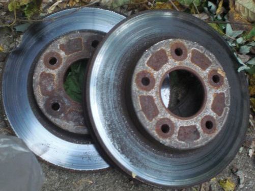

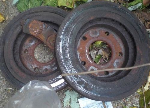

Everytime I pull wheels I grab calipers and twist them. That should retract them a little. Then I check for how they slide. If your pads are wearing evenly, both sides - front and back of rotors. but fast, check the fronts.
Could be you're getting all stopping power on back ones.
Sounds weird, I know.. but I've already found these brakes are not typical of how a car works.
This is what I took off the front a couple months ago and only because they 'looked bad'

Yes... taken right after removal and having about 3000 miles Daily driving since bought.
