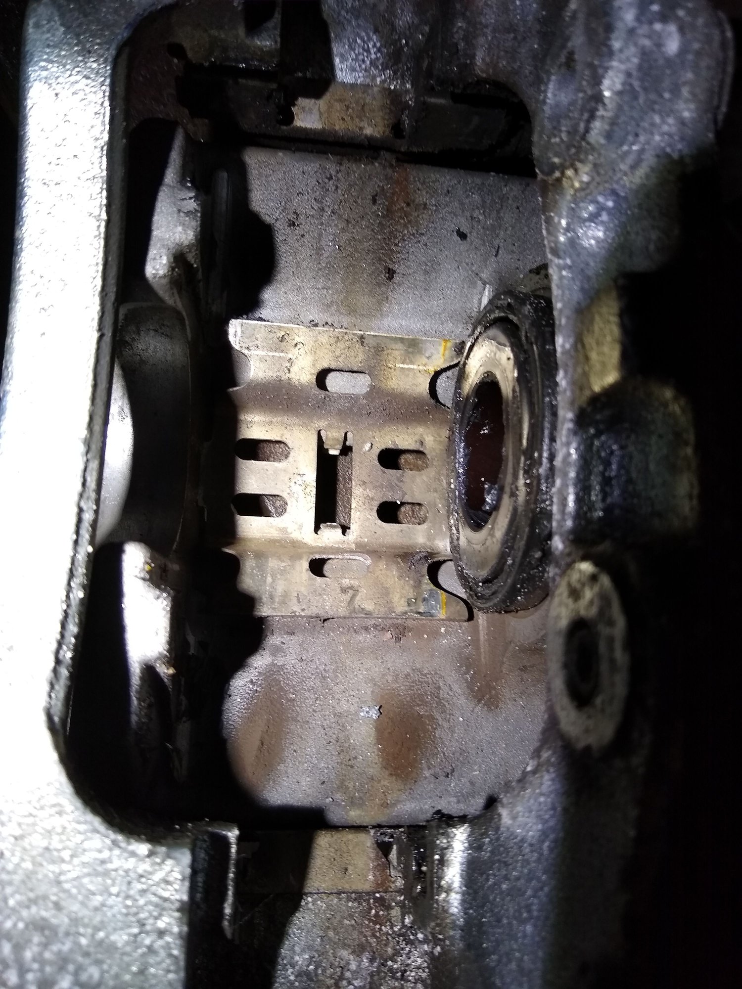

Taking things apart again, I got another caliper for the passenger side, since I saw some abnormal markings on the rotor on that side. I swear the noise is coming from the driver's side, but I could be wrong. These are the pads from the caliper I'm replacing. Do they look glazed?
To me they don't seem right, but I could be wrong.
Also there was some break dust build up in the caliper
The pads have some rough wear on the edges, not sure if that shows up in the pic above.
As for the other side, the driver's side, the pads also seem to look glazed I think. And some odd rough wear patterns, including a small piece of brake material that is hanging off if you look close:
So I'm still not exactly sure what the deal is. Could these pads just be crappy? They're supposed to be premium, but that might not mean anything. The evidence would suggest that the calipers could be to blame, since the pads appear to have overheated. But both calipers are bad at the same time? I guess I will see what happens when I install the replacement caliper. I'm about ready to say screw it and toss these pads and get a different kind.
After all this you think the rotors are shot? Ugh I'll be paying for this job twice when all is said and done.

It’s hard to assess this situation remote control with pictures. There does appear to be a fair amount of oil or grease around those caliper pistons and even on the pads to some extent. If I’m seeing that correctly that area should be fairly dry. Is one of those pads wearing in a wedge shape or is that the angle of the picture? What do the surface of the rotors look like? Some pads have a specific break in procedure that Might help. Those look like semi metallic pads which in theory have more stopping power but can be noisier than ceramic or organic pads.

Everything might look messy because I was handling it so much when taking it apart. When I first installed the pads I had put a little grease on the back of the pads.
