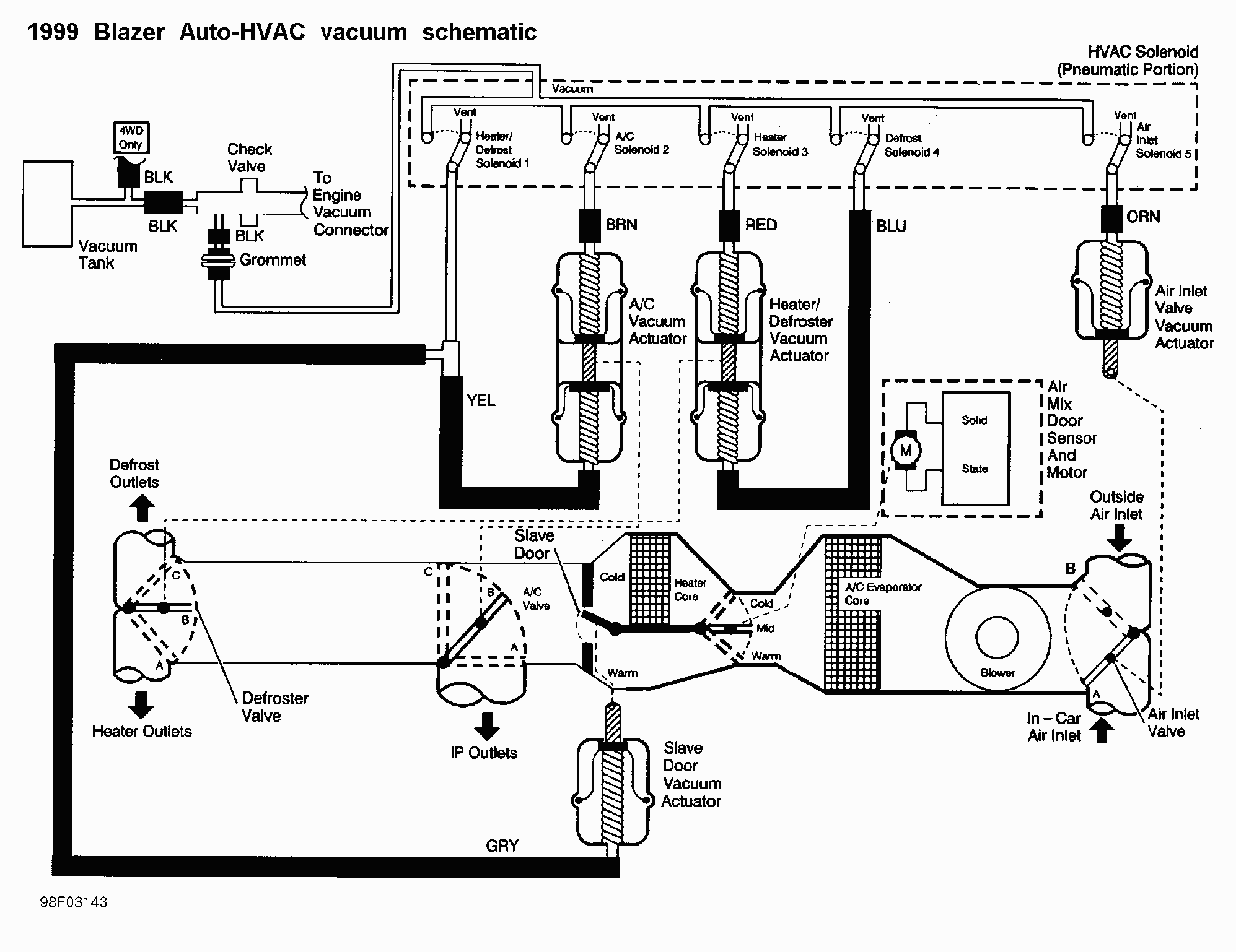

It is worth providing the year and type of key options for your Blazer; e.g. does it have the Automatic Climate Control or the manual control?
But to your problem, a likely problem with these systems is the vacuum hoses that supply vacuum to the actuators and, if you have the manual temperature control, to the valve solenoid. If there are leaks in these hoses, the actuators will not work or only work partially, especially if the engine is under load.
Since it is so easy to check the under-hood vacuum hoses, I'd recommend checking there first. As search of the forum for the topic should give you quite a few hits to guide you. After 20 years or so, the rubber gets brittle and leaks.
To get you started, here is a diagram that might help:
1999 Auto HVAC Schematic

Thanks for the replies. I don't think its a vacuum issue, I tested it at the two actuators I found and it was good, and both moved through their whole travel. I'll have a look for the door issue now. I too would love the legend that goes with that diagram. I saw when I looked that the bottom actuators did have the white arm (17) and spring in place and was moving but I didn't really look behind it to see if the rod to the door was in place or not.
Does anyone have thoughts on the cold air I get piling in through the dash itself. From that diagram its obviously not the mixing door or the fresh inlet door as I don't get it out the vents, its coming from everywhere else. I'm not sure what holes etc under the hood I should be looking at. I may start a different thread for this issue as I don't think its related to the heater controls.
I have a 2003 with the manual control setup.

I believe the exploded diagram posted by kennycraze came from here: https://nemigaparts.com/cat_spares/epc/chevrolet/
I liked the diagram so much I tracked it down. Look of your year range for the Blazer.
