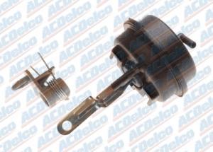

So I changed the water pump, put a new thermostat in and still no heat.I then went and had the system flushed just in case there was a blockage in the heater core.After that there was still no heat so I was told the actuater for the blend door was bad and was behind the glove box but it wasent what the guy showed me
( the above pic is the actuatuar he showed me )

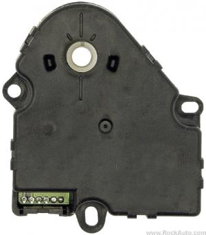

But what I found was this
When I reached up in there I closed the door with my hands nd it made the heat a little warmer but not enough to make a difference when it -10 out.please any help would be awesome.

What your mechanic showed you is behind the vacuum actuator that you found. Remove the vacuum actuator and you should see the motor-driven actuator.

I will look thank you, what door is the vacuum actuator opening and closing then?

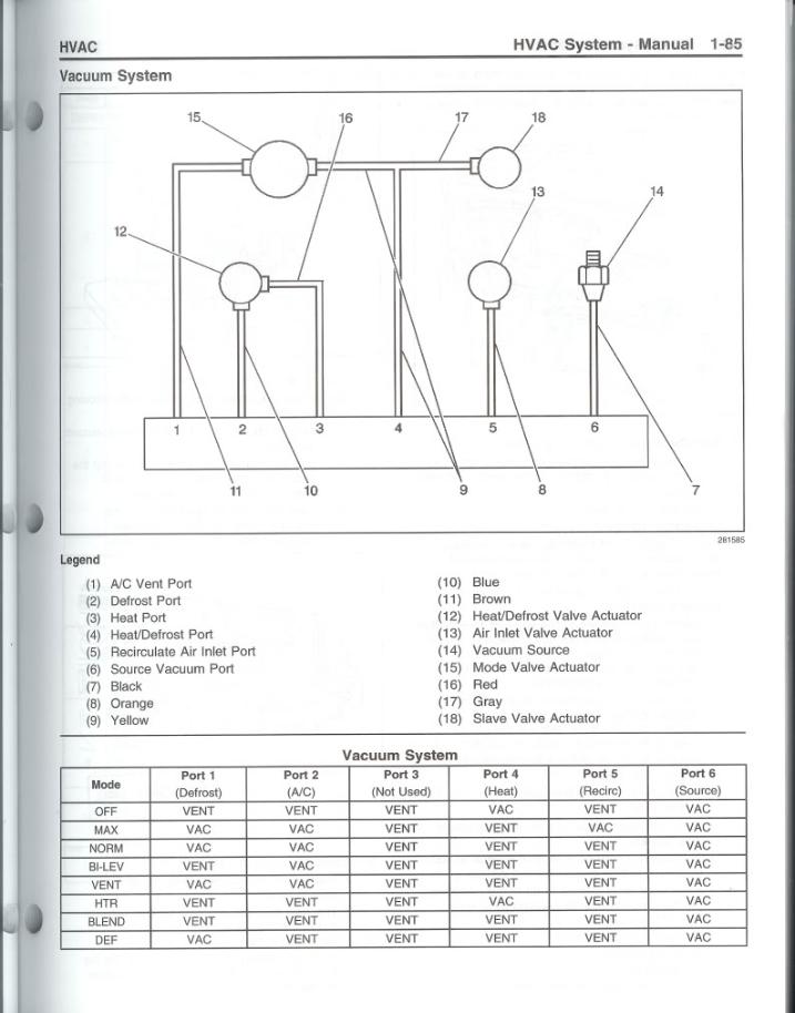

Couple of diagrams might help:
