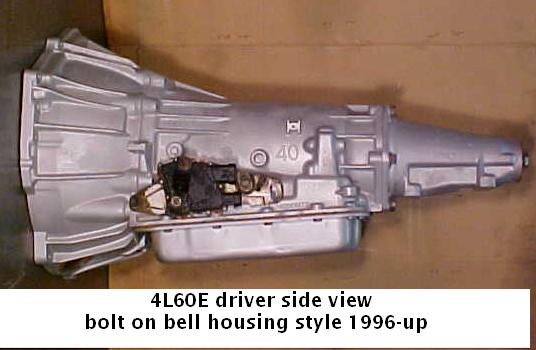

The NSS is on the side of your transmission.

Big box on the drivers side of transmission is the nss
I also have the same issue with the sporadic flashing tranny gear selection crap. Pretty sure mines related to a bad ground somewhere between the body and block/frame, just haven't gotten around to it yet. Look up a wiring schematic and start having fun tracing that crap back!
