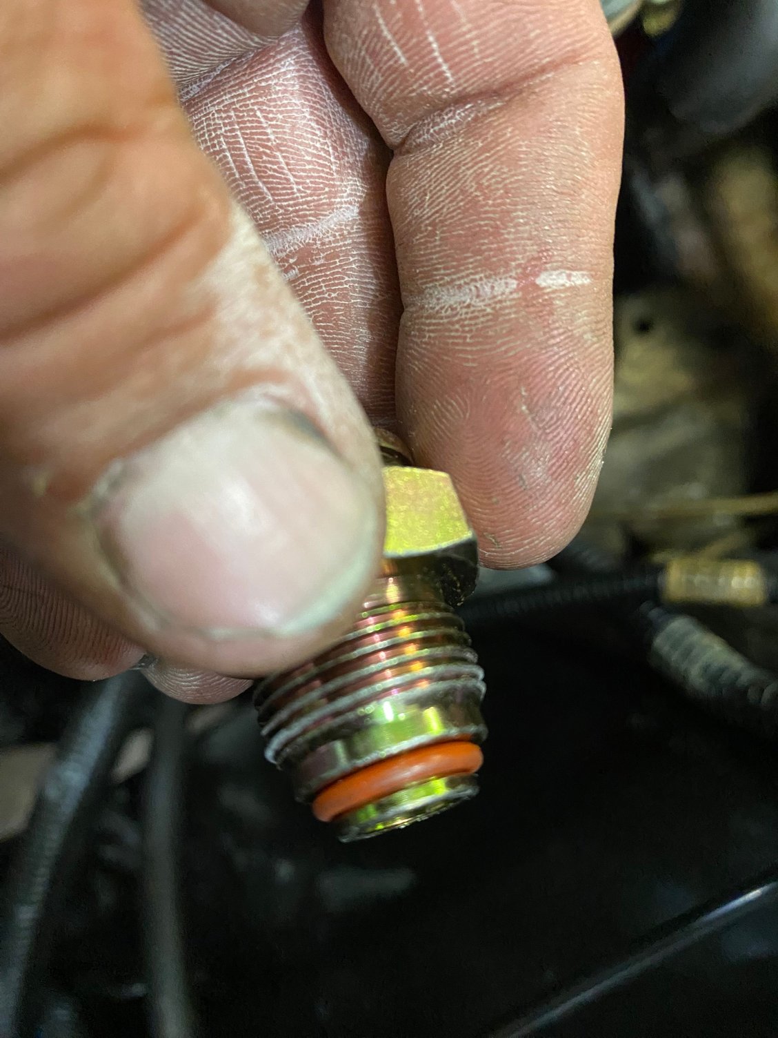

Ok pics of before.
1st. Cut off end of fitting and grind down as needed. I went farther then I wanted as I wanted to smash the oring tight enough for a seal but not crush it and have tight threads as well.

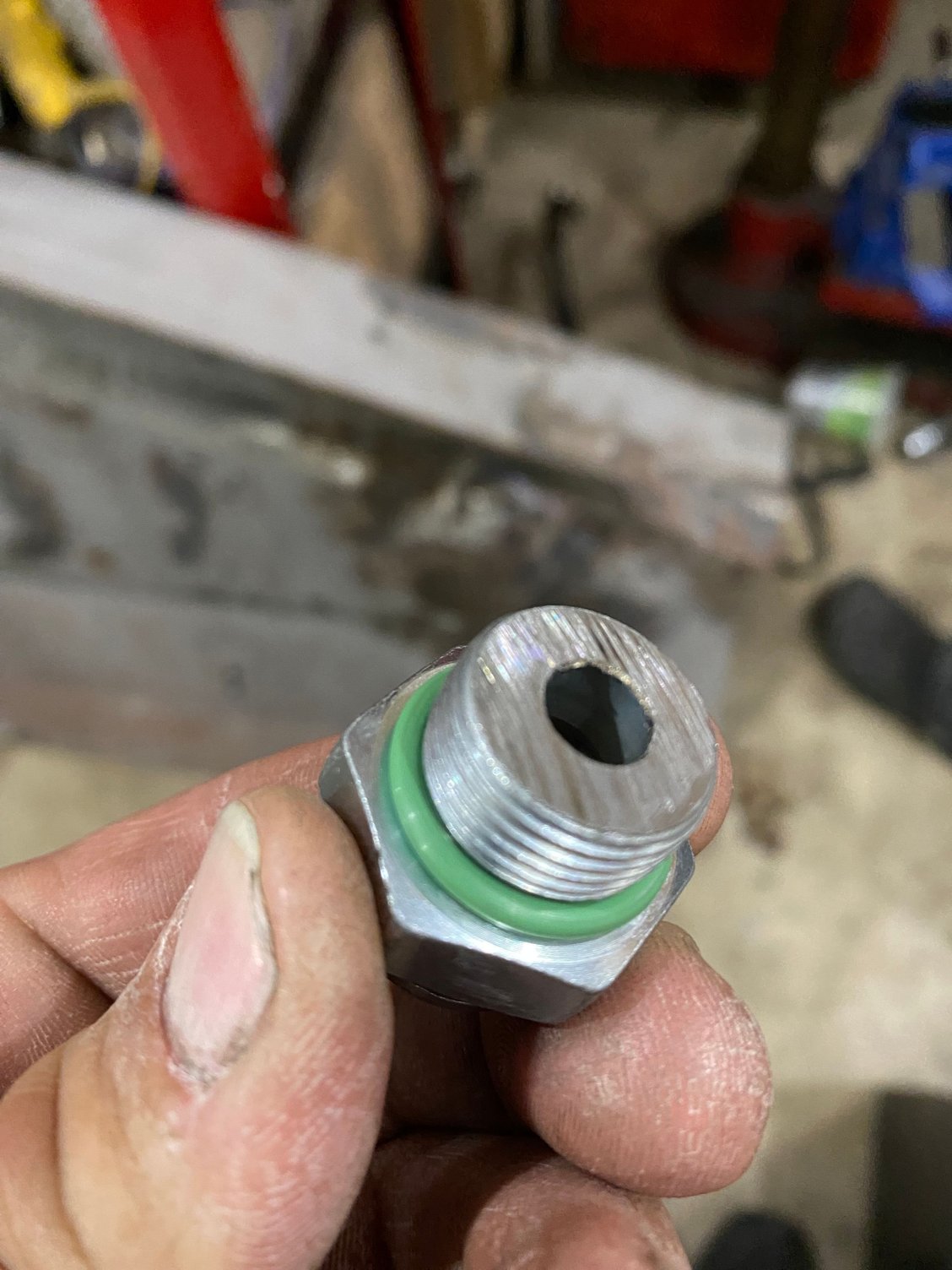

2nd.
I added dielectric grease using a small pic to get just enough on the base of fitting for oring to spin freely. But not get on the threads and mix with thread sealant as it does cure hard. Same product used for head bolts.
3rd.
install and tighten up. I will be using radiator manufacture fittings for a final cut to try to get tight threads actually, along with a tight seal by grinding down a little less. This is what my first fitting attempt looked like. FYI: the fitting is very very soft doesn’t take much.

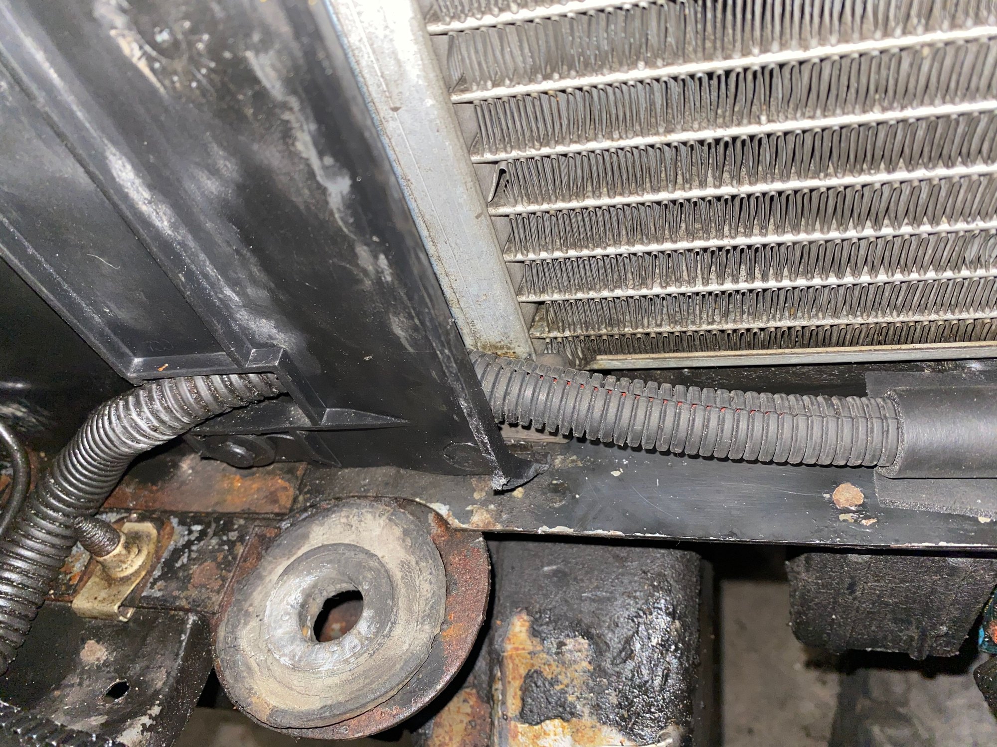

4th. I wanted to address the heavy gauge battery to fuse box wire on this forum, after reading thru Christina’s build and one of the others that ordered the same radiator said he had to move his but didn’t go into details. It sounded like he actually did a bit more work by simply saying he moved it, So I wanted to give a simple fix for others in the future.
I used an old 1/2 extension and a 4lb sledge to indent the factory indention deeper on the side that meets the front lower plastic of the 3 piece fan shroud. Took a half dozen plus hits. Worked nicely though. You’ll also notice hvac foam tape used to secure wire on top of the core support without drilling any holes causing a rust issue. Product holds up to oil pretty well in hvac lines and sticking to the refrigerant lines so I felt it was a good option. Not worried if it fails down the road really as radiator will be in place.
