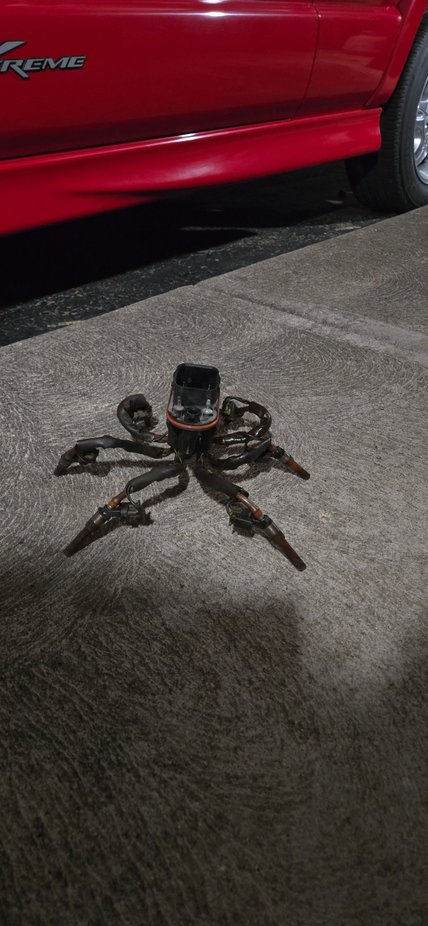

Ok guys and gals, here's my last and final update on the spider injector problem. As of 3:40am I got the old girl running like a top and even took her out for a quick little test drive around the block! I started reinstalling everything at about 12am. It is now 4:31am as I type this.
Yes the hours may seem a bit odd but I work 7pm to 7am and it's my last night off from work until friday so they're pretty normal for me. Had plenty of light to get er done. And it is refreshing to be able to drive her again.
Surprisingly enough despite all I've read saying you have to do the TB relearn and other relearns when you disconnect stuff. I did not. It relearned on its own during the initial start up and restart for the test drive.
And the PCM is fine! Works great still!
The spider injector I purchased:
GP Sorensen Fuel Injector 800-1512N - Autozone - $321.99
The upper intake manifold gasket kit I purchased:
Fel-Pro MS95816 - Autozone - $27.49
I would like to thank LesMyer for all your tips, knowledge, insight, and help!
Some takeaways from this repair process:
  1. It does not hurt to go over everything related to the issue before you tackle the smoking gun! (gives me peace of mind atleast)
  2. Take your time and do it right the first time so you don't have to redo it.
  3. Be very thorough in all of your inspection so you know for sure.
  4. And in light of Halloween just around the corner...........wait for it........
BAM!
I now have new/old Halloween decoration that would scare any 4.3l or 5.3l owner out there
plus I got a new pet/guard spider🕷! Just in time for Halloween 🎃
As far as everything else...
This chapter of the trucks needed repairs is over and closed.Thanks again for all the help!
