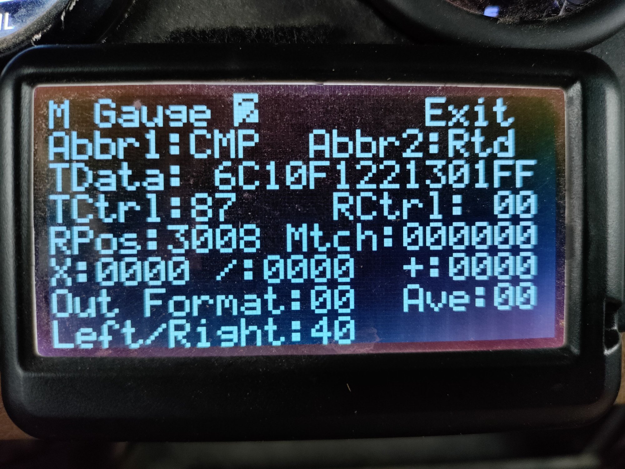

Do any of you guys know the PID formula for CMP retard? I'm trying to program it into my UltraGauge MX. I've got the header and the code entered but it's not displaying the data. I'm thinking there must be a formula I need to put in?

LesMyer May 16, 2021 03:30 PM
Nope. They have been trying to do that in Torque Pro for years. Never seen it to work. If you want the supposed formula, go on the Torque Pro Forum. I tried it in Torque Pro - didn't work.
for a 1999 get Car Diagnostic Pro if you have an Android. Dash Command if you have I-phone and opt for enhanced PIDs from within the software.
