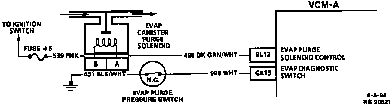

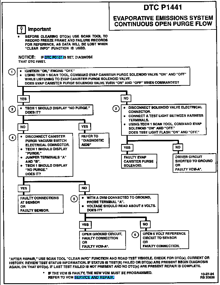

This code is for the Evaporative Emissions system, not the EGR system. The EVAP system controls the evaporative fuel vapors from the fuel tank by putting the fuel tank under vacuum
P1441 - EVAP System Continuous Open Purge Cycle Flow
This is mostlikely caused by a faulty EVAP purge valve.
Here are the schematics and diagnostic flow chart... Requires a Tech 1 scan tool though...

No, advanced auto would not. At most they could tell you the code which you already know. As the diagnostic chart I posted above states, you need a tech 1 scan tool (dealer) to perform the proper diagnosis to determine the cause of the failure. As I said, it is mostlikely the purge solenoid.
