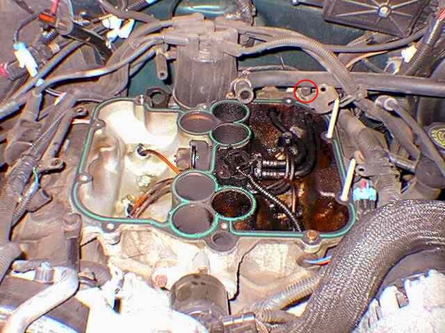

Hi all I'm totaly new to this sight and not sure what i'm doing But i'm looking for the FUEL pressure test valve for 95 jimmy SL with 4.3L vortex engine can anyone help with info and pix it has to be 95 heres a pix where Haynes says it is other then this looked everywhere with no luck please help thanks

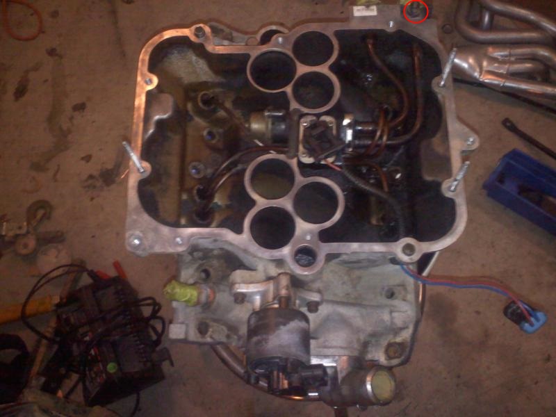

Old Jan 26, 2013 | 07:48 PM
Posts: 41,345
For the CPI motor that is in the OPs '95, the fuel pressure test port is located off the driver side rear of the upper plenum. Here are a few pictures showing the test port cap with the upper plenum removed:
Attached Thumbnails Please help if you know this-95_cpi_fptp.jpg   Please help if you know this-95_cpi_fptp2.jpg
