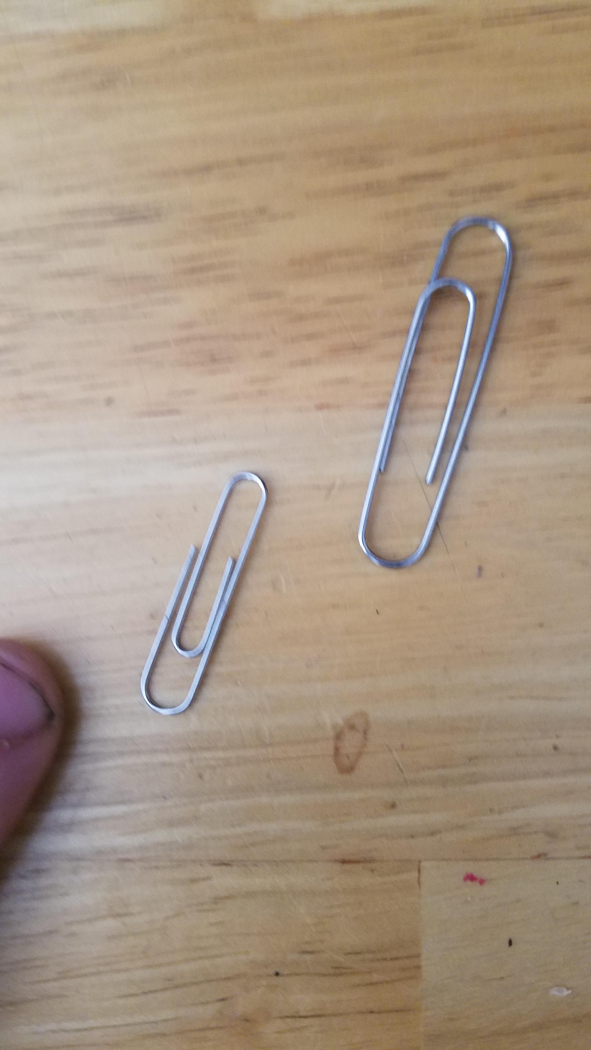

The low pressure cutout switch simply closes its contacts when the pressure is appropriate and opens them when not. So to bypass it, all you need to do is jumper the contacts in the connector with something conductive (paperclip) with the connector disconnected.
I will try it again and with another paperclip however I did try this and I did not get an engaging of the compressor. I know if that thing on the outside is spinning then it is engaged.

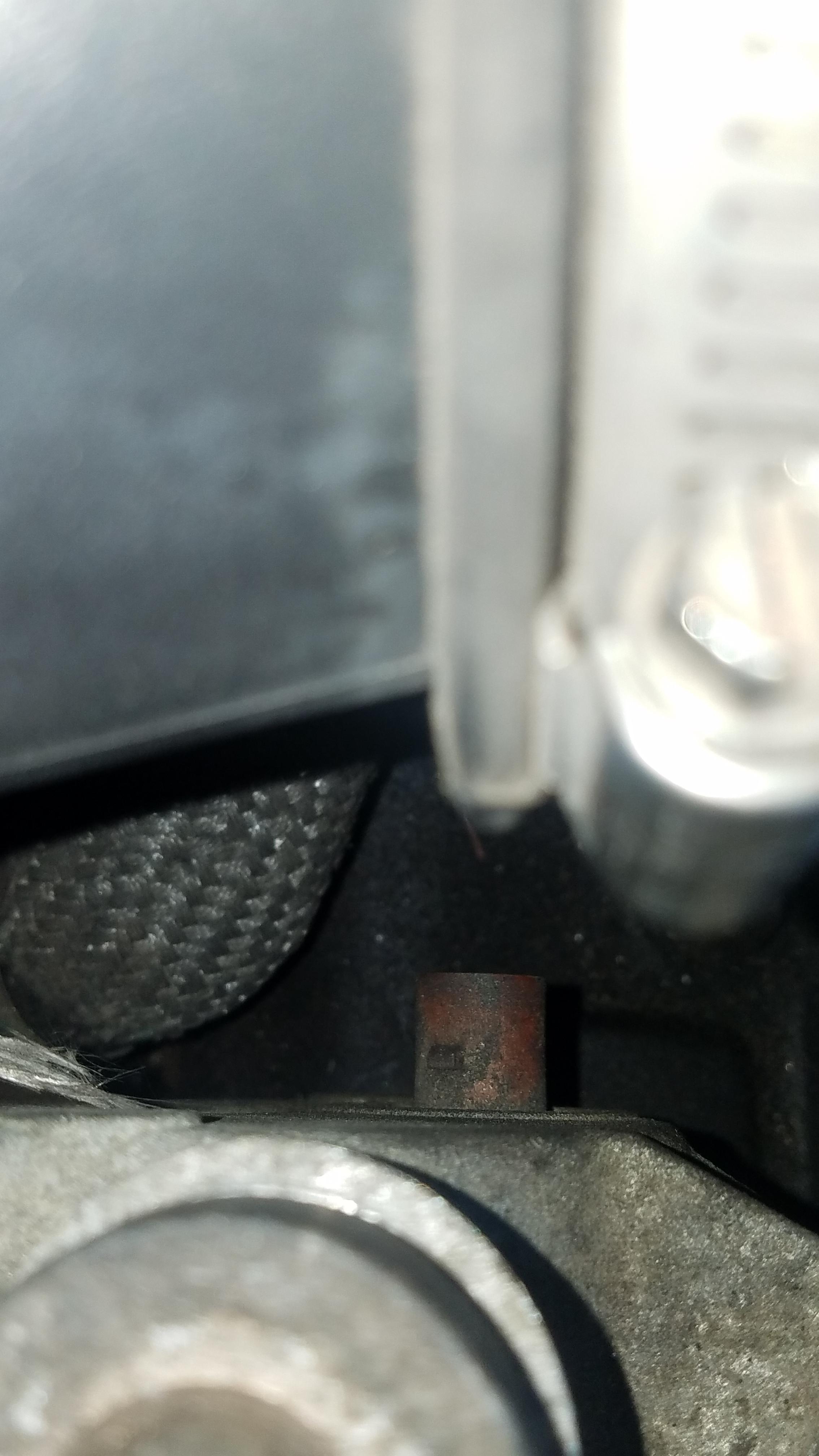

So.. I was able to get the AC to function. Compressor spinning,
Interior cold, feeling nice... It turned out to be two things.First, the High Side switch was not connected. So I went ahead and connected it. (I did not know this was there.)
Second, after disconnecting a "can of oil" (Ester oil, the little $7.99 can from Advance Auto) that did not seem to want to be sucked in, or sucked in very very little, either one.. could not really tell. BUT. After disconnecting that one, (with a lot of stuff left in it that did not go into the system).. I then put in a small can of R134A and the compressor came on almost immediately after that.
