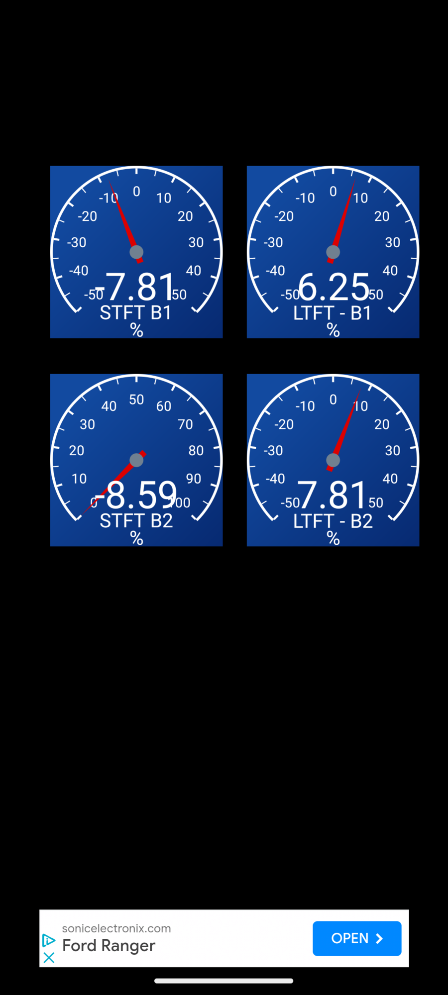

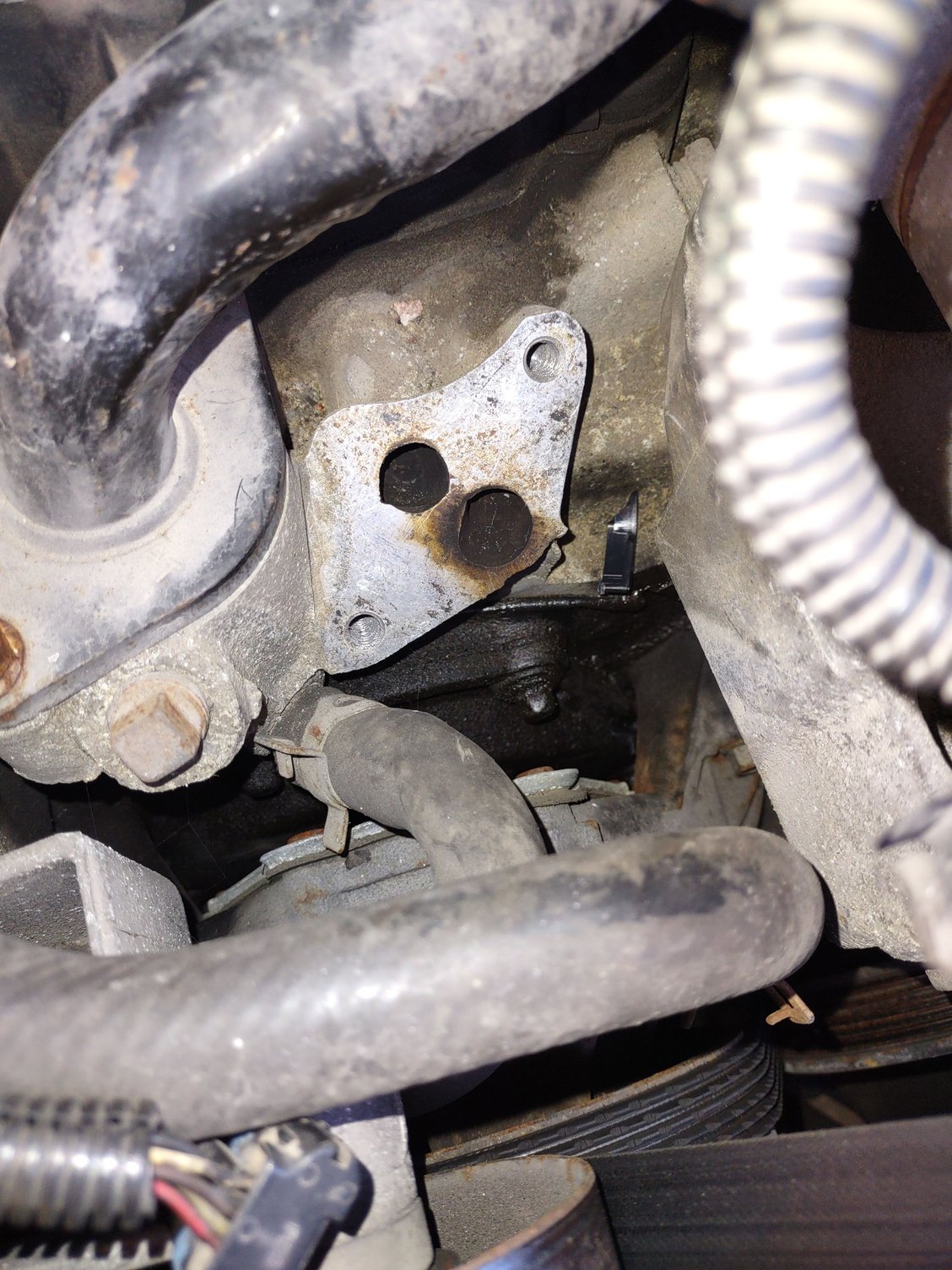

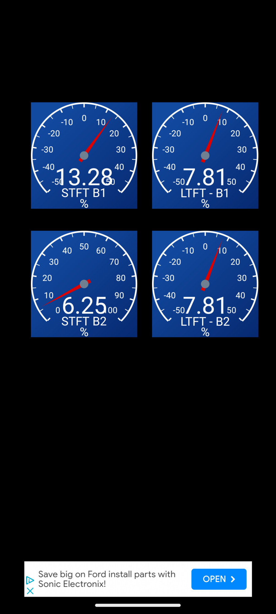

I found torque spec to be 18 ft lbs or 21 ft lbs. The replacement cheapie egr broke just like the original one did. I just went to the parts store and got a better one. Tightened it and it didn't break.
My new trim numbers are below, first set at idle, second set at 1500rpm. Seems they aren't perfect but much better. Also for fun I am sharing what the broken egr and the mounting surface on engine side looked like, can clearly see a path that doesn't belong there.

Forgot to say, the exhaust/fuel smell is no longer eye watering or even noticeable. It was very strong before when the fuel trims were up at 50.

Yeah, I'd say the gasket failed at a minimum. Idle trims seem a little high unless it's still warming up but I'd probably take a 'hide and watch' approach to see what it does with the long term values if it seems to be running okay now.
