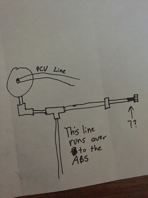

Right around the pcv valve on the drivers side it connects to a check valve t. From that check valve T, it either runs to the drivers side panel, or it runs to this bolt. If that makes any sense. I'm a new member so I'm not sure how to post pics yet otherwise I would.

This is the diagram I made from what I saw.

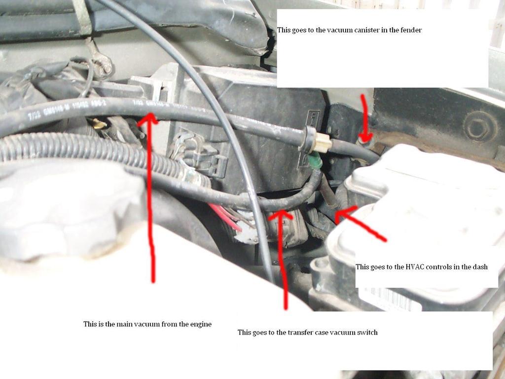

Thinking its a vacuum line for the 4 wheel drive or hvac. Does your 4 wheel drive work or do your heat vents change. Floor/defrost/interior?

Attached Thumbnails Random vacuum line with bolt in end?-2013-01-23_033936_blazer_vacuum_lines.jpg
4 wheel drive works. Heat works but softly blows even when turned off. Random spurts of cool air sometimes
