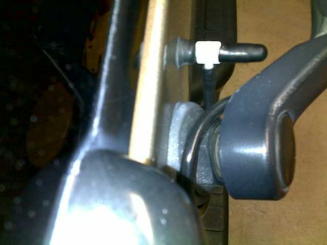

Been there. Mine broke off too. If I'm understanding you correctly, then you're looking for the plastic 90° washer hose fitting? If so, then you're going to find that your Chevy dealer will only sell that little hose fitting with the whole rear wiper arm assembly. I had no luck finding anything small enough at any of the usual auto parts stores, so I got creative and used a T fitting with a plastic cap on the one end that wasn't needed.
NAPA auto parts has a plastic box behind the counter with a large amount of shapes and sizes of fittings and had one in the correct size, but only in a T fitting. It worked perfect for me. Remember that there's a piece of the old fitting broken off in the rubber grommet that needs to be taken out before you try shoving the new fitting inside. I used a small drywall screw to twist into the broken piece and then was able to pull it straight out. Good luck.

it just pushes into the grommet. Mine broke off too short to get a hold onto it with any sort of tool, so as I mentioned above I used a small diameter drywall screw. By twisting the screw threads into the broken piece left inside. Just twist it in with your fingers and pull straight out. It doesn't have threads on the fitting, it only has a couple of barbs circling the end of the fitting. It's an easy 2 minute fix. Good luck.

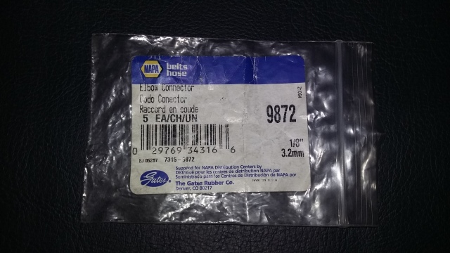

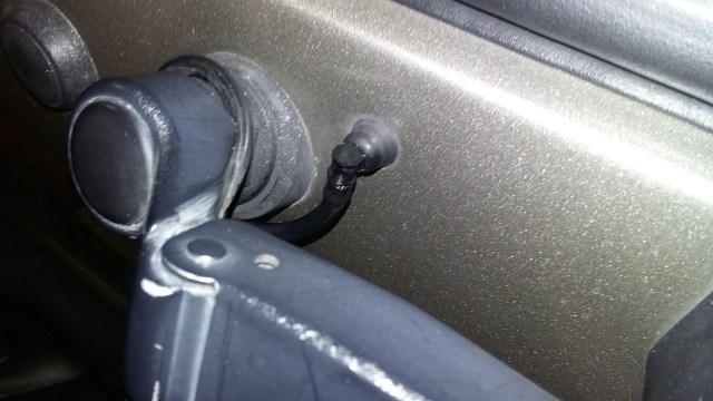

I washed my Blazer today and once again I got a little rough with the towel while drying it and broke off the plastic elbow that attaches the rear window washer fluid hose to the tailgate grommet. The dealer shows that the small plastic 90° elbow is only available with the purchase of the rear wiper arm, Screw that! I went to NAPA Auto Parts and found the perfect size replacement.
Here's the NAPA A/P part number:
It's not as easy as ya might think to hunt one of these little things down, I tried 4 other places before I lucked out at NAPA
