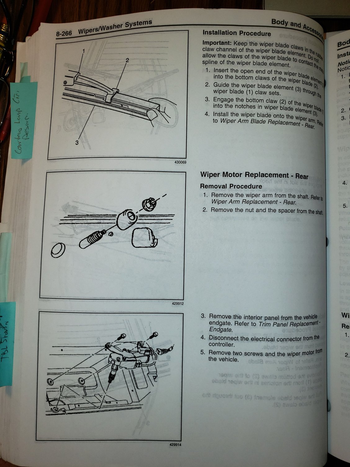

I have a 2001 Blazer. I need to replace my rear wiper motor. I removed wiper arm, 2 inside torx nuts and ground wire. The motor is sitting loose. I am unable to remove the motor because of a plate blocking the motor. Any suggestions on how to get the wiper motor out with or without removing this plate. Any suggestions are appreciated. Thanks

This is from my 1999 manual.
