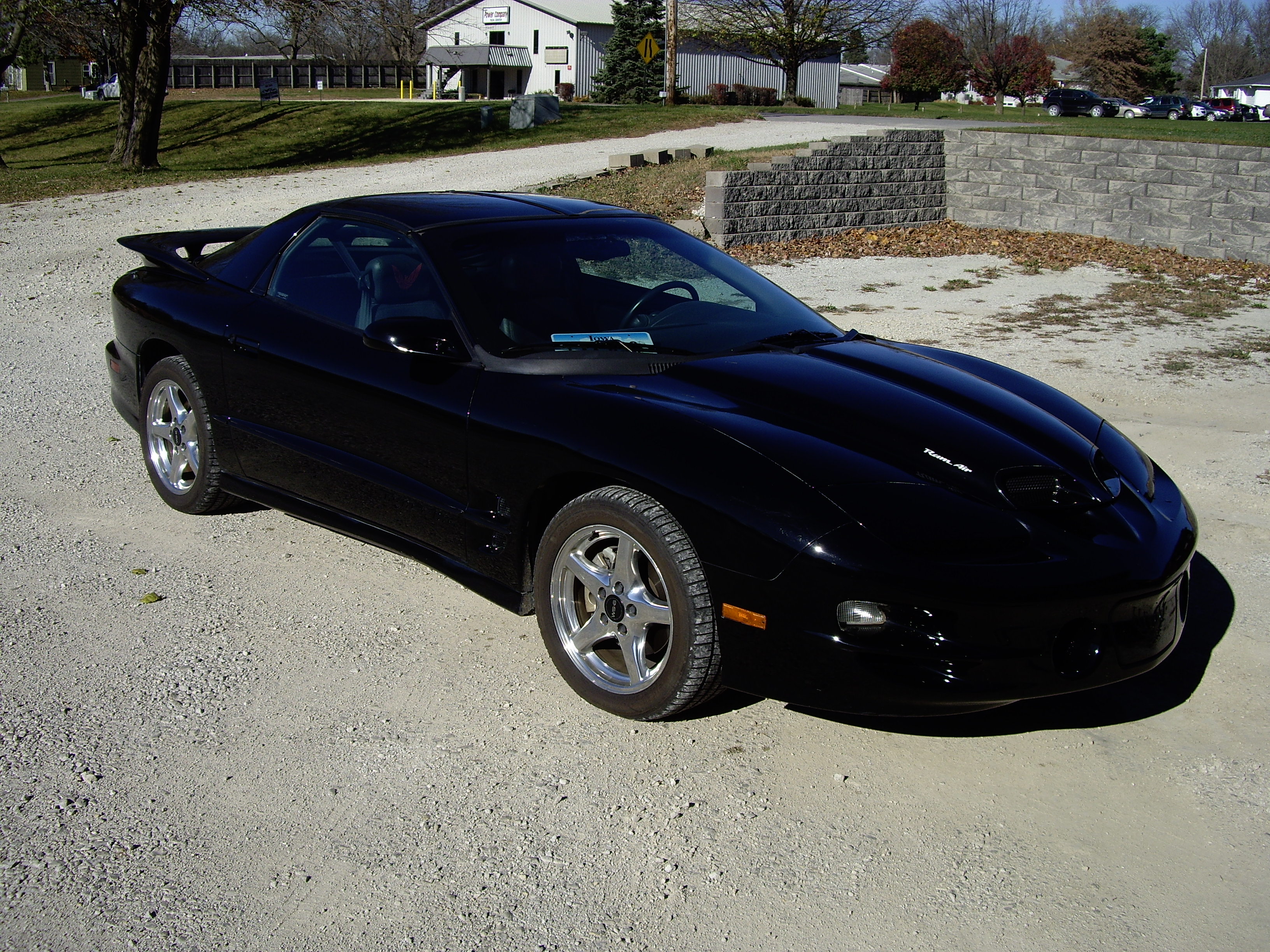

It's just a T/A WS6 and could use a good professional polishing. The 6spd is a blast to drive though and it's parked at my place. Possession is 9/10ths of the law right??

Originally Posted by CWBDDSPC
Attachment 29565
Those are fun!
Attachment 29565
Still a VERY nice ride! I would love to have one!
