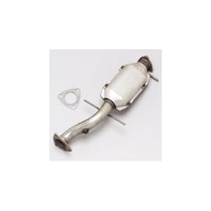

I'm thinking about getting the catco direct fit cat because it has all of the hangers i need. one on one side of the cat and two on the other side. here is a pic http://ecx.images-amazon.com/images/...500_AA300_.jpg. and for 170 bucks it isn't bad. it has all the hangers i need, so i wont need to weld at all. but is this a good brand? the only other cats that i could find with all of the hangers i need were made by davico (http://www.autopartswarehouse.com/sk...gs+Best+Seller ) and the eastern catalytic one with the same configuration, but i read in a few places these brands weren't that good. The only one out of the three that comes with a warranty is davico. So i have come to the best place to get an answer by blazer enthusiasts... am I making the right choice by choosing catco?
