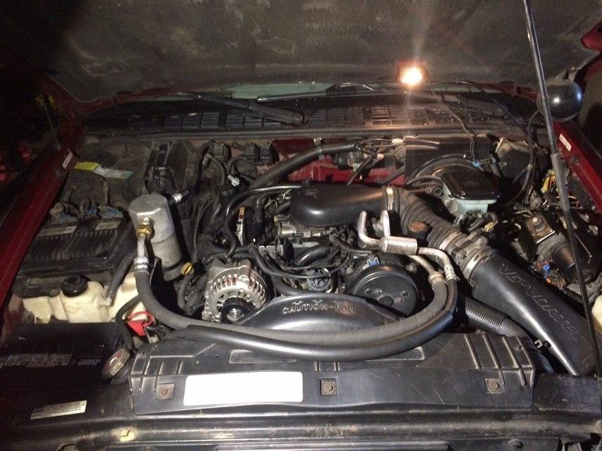

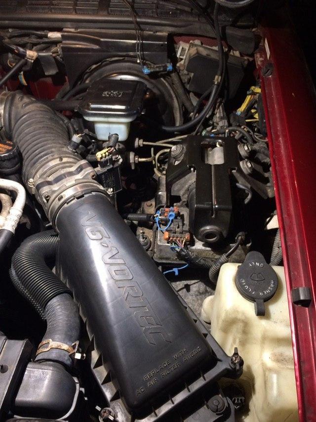

engine bay picture? what model year of truck do you have.

Swartlkk Already mentioned. But mine's a 1997. Here's the Engine bay and the driver's side as a closeup.
