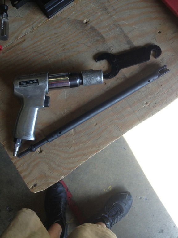

I use this
Attached Thumbnails Replacing the water pump so how to i take off the fan and fan clutch off of the water-79c58f14-3aee-434c-8f43-c350df21eca8_zps1zxa3as8.jpg

1. a strap wrench to hold the pulley, and a large adjustable wrench on the nut, turn counter clockwise and it'll budge, sometimes gotta hit the wrench with a hammer for a bit of an impact.
2. Rexmburns's method - air hammer with a chisel, I put the chisel right on the edge of the nut, one quick blast and the fan is coming right off :-D This is my favorite way.

No chisel in my method it's a tool specifically designed to remove fan clutches using an air hammer that takes about 3 seconds of pulling the trigger and then finish removing with your fingers!
