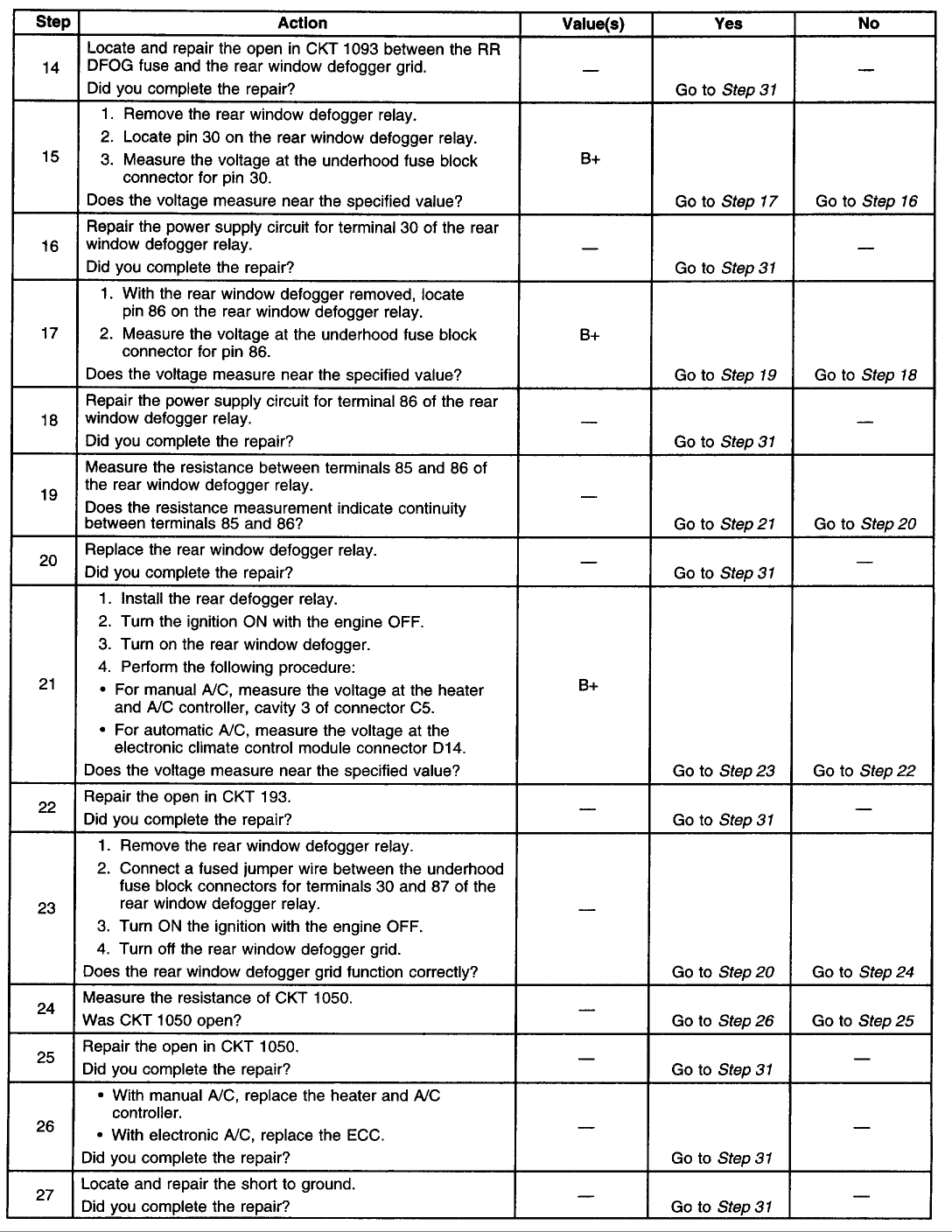

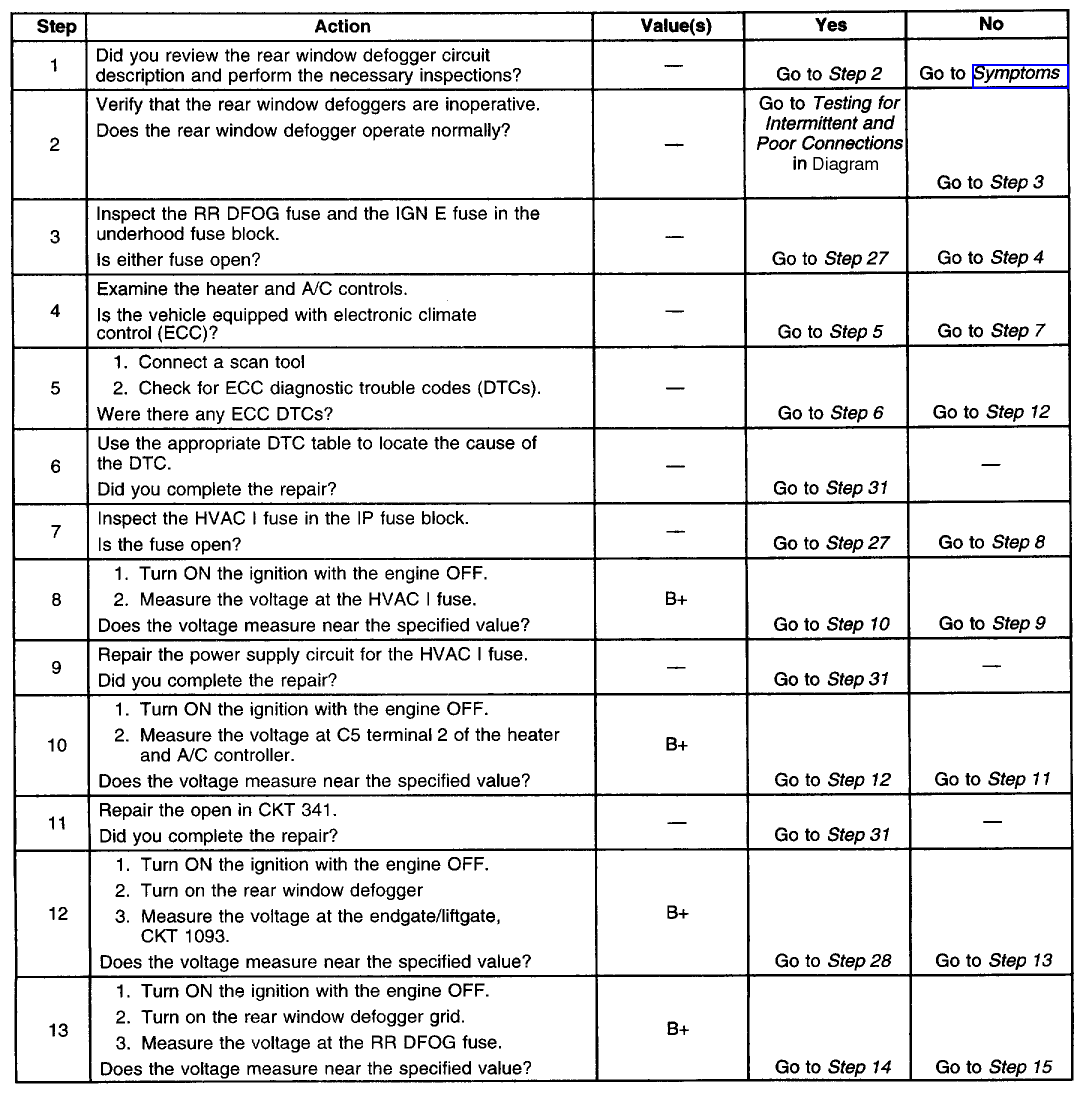

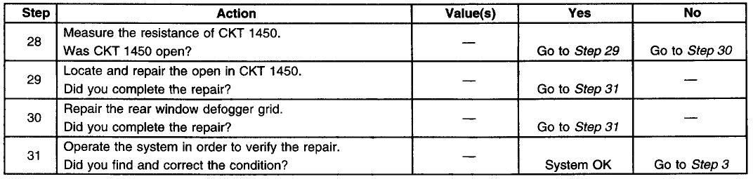

Here's the diagnostic flow charts for this problem:
As you can see, there are two fuses that can affect this. If you find that you need further information when going down through the list, just let me know.

Well Kyle, you pinned it with the flow chart. No power supply to the RR DEFOG fuse. The wire pulled out of the fuseblocksomehow and there was no power at the fuse.
