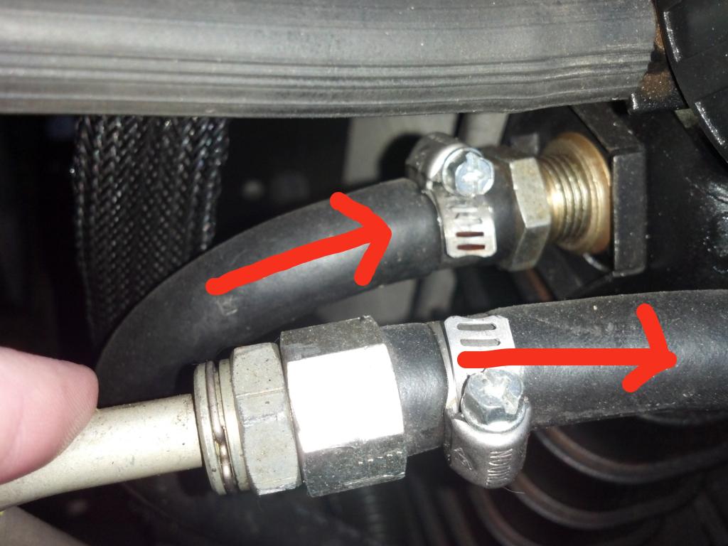

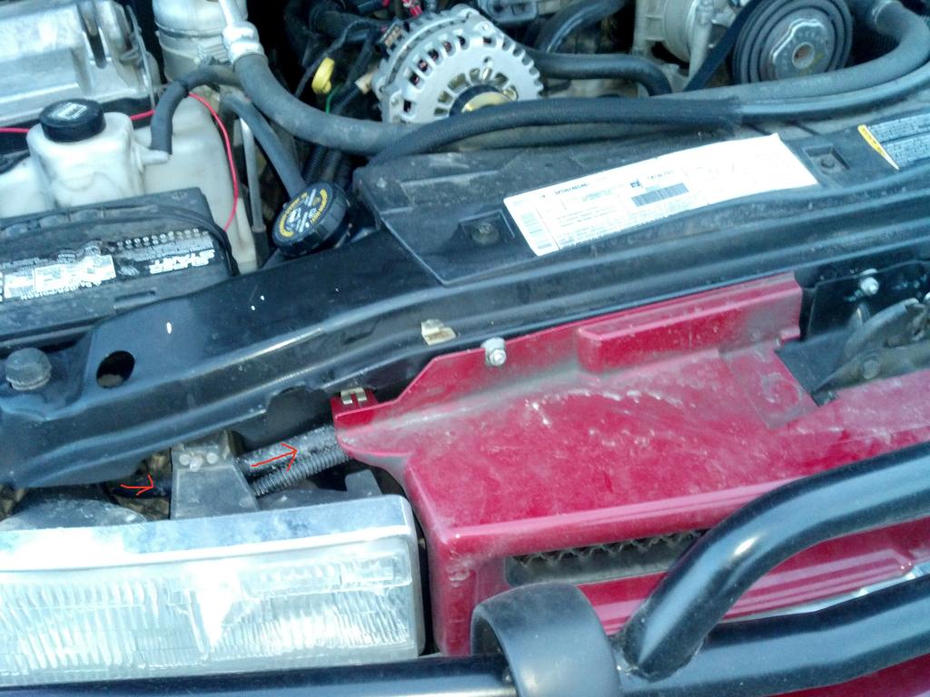

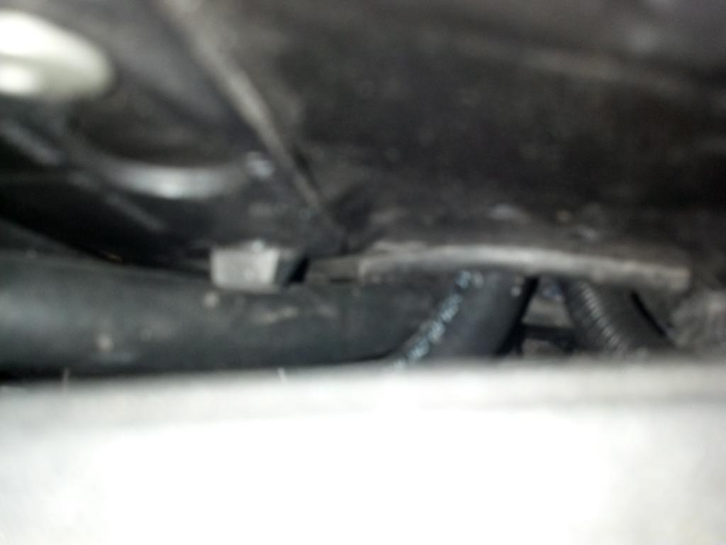

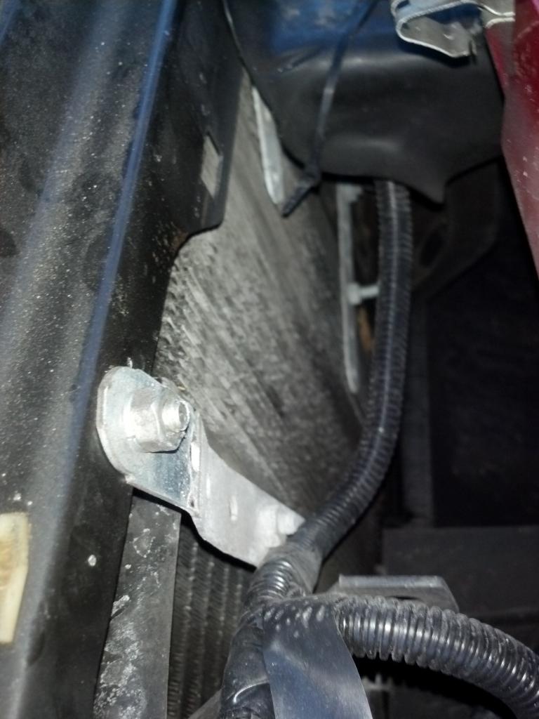

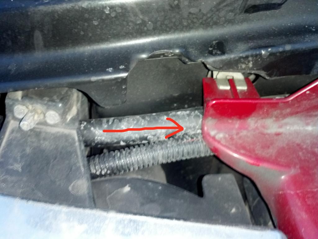

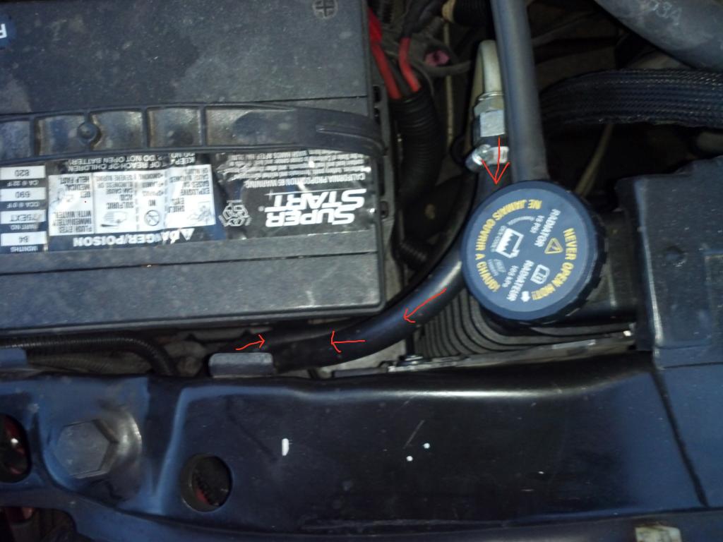

I like my B&M cooler, $62 on amazon right now
Amazon.com: B&M 70268 SuperCooler Automatic Transmission Cooler: Automotive Amazon.com: B&M 70268 SuperCooler Automatic Transmission Cooler: Automotive
I can tell the difference with it. Being the PO put in a billet servo after putting the cooler in it kept the shifts firm after getting up to running temp.
Here are some pics of my install if interested. Cooler had just the right amount of lines for my truck.

Make sure your transmission feeds the stock cooler first then your aftermarket cooler, because the radiator is not going to cool it as much as your cooler out in front of your ac condenser. You want it going straight from your aftermarket cooler to the transmission.
