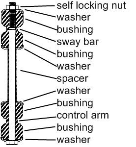

Ok, while looking underneath, I noticed that the bolt on the end of the Stabilizer Bar has some spaces in-between the rubber bushings and there is no NUT on the top of the bolt. This does not seem right and the Haynes manual does show a nut….is the manual right? Why hasn’t the bolt come out?

If the washer on the top is a large hex on the outer surface of the washer, then it has a threaded portion in it which extends down into the bushing. Many factory sway bar end links were like this.

The original sway bar end links had a plastic spacer between the upper and lower attaching points. An after market one will have a rolled piece of steel like the picture below illustrates:

As for the stabilizer bolt nut question…..guess I’m blind in my good eye.[:@] Last night with a flashlight in the garage, all I saw on top of the bolt was a rubber bushing. NOW I see a very thin black metal washer type of nut that is on top of the bushing….and yes there is a spacer in-between the other bushings. Thought I may have found something to get my grunts out!
